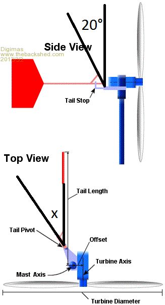

Here's an image illustrating my question. What is the angle x?

No, looking at the side view should be 45 degrees not 20 degrees.
The other angle would be looking from the back or front, the tail pivot post will be leaning away from the tower mast 20 degrees from vertical.
I would do you a picture but I am late for an appointment. gotta rush, sorry!!

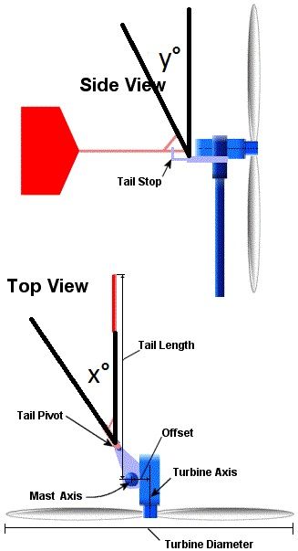

Just for clarity, could someone fill in the values for x and y in this image?
Posted: 03:29pm 02 Mar 2013
Y = layback angle (about 2 degrees)
X = side angle (about 12-15 degrees)
