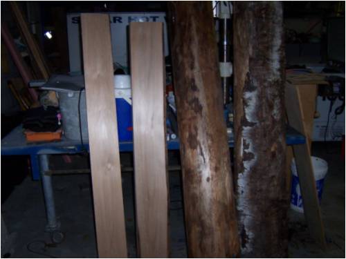

Posted: 08:48am 15 Jul 2008
OK so far the turbine is made except for the tail but thats no big deal the timber for the blades was bought from the australian timber traders in mossman Photo shows before and after all this timber is normally left to rot so I got 6 pieces for $20 I am more than happy with the end result after some processing buy me after work today. Wish I had more time to spend on this but like everyone work comes first.Next step is to carve the blades.should spend more time working on the progect instead of in the back shed but you know how it is ,more to come soon Mick
Every day the sun shines
& gravity sucks= free energy.
Gill
Joined: 11/11/2006
Posts: 669
Posted: 10:35am 15 Jul 2008
Great work Mick. Have fun with those blades. The timbers looks good. From the pic I'm guessing you've dressed two down from the rough, like those on the right. Stick with it, Rome wasn't built in a day either.
