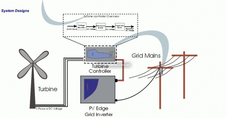

Hello,
The typical solar grid tied inverter has a large input voltage range maybe in the range 110Vdc up. If I found a turbine that produces an output in this range or I installed a transformer, can I connect the turbine to the inverter without the need for batteries? I have seen recommendations in other forum posts to use a battery bank between the inverter and turbine (Lantronix for example). I was wondering if the typical inverter requires a rather steady DC voltage delivered from batteries or if it could handle the turbine dc voltage which is up and down and all over the place.
The reason I ask the questions is that it is such a waste to see a Solar panel inverter not being utilized at night. Perhaps a wind turbine could be attached. But then if I have to add 10 batteries I might aswell purchase a 2nd inverter, ie the Windy boy which doesnt require batteries.
Thankyou.

Regardless of the output voltage of the turbine.
My question is whether or not the batteries before the inverter are necessary. I would think no but then maybe someone knows something about these inverters that I dont.

http://www.latronics.com.au/products/turbine-controller
Posted: 03:18am 01 Jan 2013
Your question was to use the GTI to feed power from a mill to the grid, there is a range of problems here, from high enough voltage from the mill to reach cutin, then anti islanding and connect delay of a GTI, etc.

360 volt turbine with on grid controller

I am informed. Thank you. I noticed the Lantronics Turbine controller still uses a capacitor bank as opposed to batteries. I guess the capacitor bank is necessary to dampen sudden voltage spikes.
