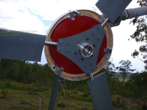

Shows inside the cowl with the cooling air flow fin.

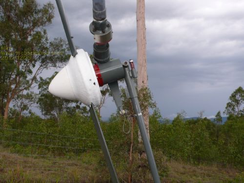

All assembled and ready .

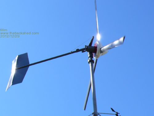

Me too , but got in to it through the blog page ok , nice looking mill .
Whats the idea behind the bend in the tail , trying to make it track straighter into the wind ??

Yea Tas , Tail offset is overlooked a lot of the time because maybe poeple think like it's a plane or something , the tail is kicked 15 to 20deg so as to balance the blade off-set force in light to medium wind which trys to keep the blades as square to the wind as possible until furl moment.

Hi Phill,
I have a small fibreglassing business that among other things makes covers for windmills.
It intrigues me how you get the finished nose cone off the mould with all the retro curves.
I have a modified OEM mill (500watt) and have often thought of doing a nose cone for it but couldn't justify making a mould for a "one-off" job.

Hi David,
The whole cowl assy is made up of 3 sections and the nose cone is held on by a piece of 1/4unc all thread that screws into the bearing cap, the blog shows a bit more detail.
Pete will have a nose cone one day to soon to play with ,as I have always thought similar thoughts, the 500w looks just plain ugly with out and it would just finish it of , and salad bowl nose cones just don't do it for me.
Pete....If it was moulded from that, I dont think I would be playing with windmills

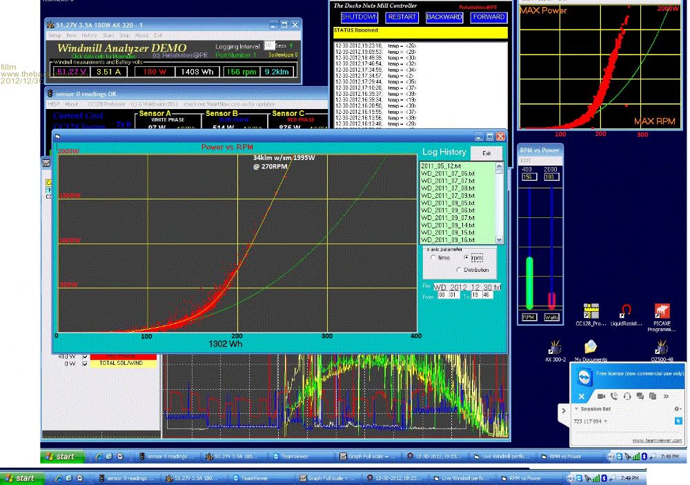

Had a bit of wind to test with today nothing to strong but a couple of good blows , below is screen dump of the logging screen, the output and logged data for today which maxed @ 1995W @ 270rpm in 34km , but the best thing is the stator temp never went over 46deg and pulled back soon after where the old Ax would have been pushing 90~100+.
The 100W difference in the watt/hrs is because I had the log save off while I was playing with different Capacitor/doubler combinations and with an AC coupled Boost module to see how much extra load can be put on the blades , that is the scatter of red dots above tha main line .
The green and yellow that can be seen are the 2 grid inverters and the blue , red and white the house power.

Mate! you need a bigger screen im sure you can fit some more on it, than how many eyes do you have, i get dizzy with the picture.
All the same excellent results thus far, and i cant wait for a big blow to come through to see what it makes, thats if Brians mate the leprechaun dont hex you before hand.
