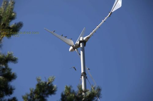

Here is a picture I took few years back.
Swallows really like the windgenerator..
They keep meetings in autumn and wait for the right
northern good winds, to move to the south with the
the power of the wind for free.
It would be very interesting, to hear how your windgenerators
will work
It has been very windy here in november and average energy production
with windpower has been 15-45Kwh per day.
All my energy need is covered with this.
I live in a small self built low energy house.
All my lights are Led etc
All the windpower I load to my batteries 2000Ah 24V NICAD.

Hi, that is great picture of the birds. How high is turbine mast? Have you had any bird strikes?

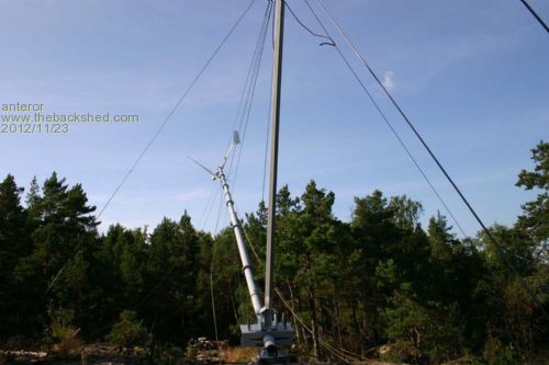

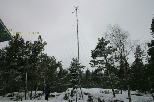

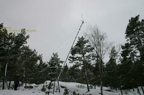

Some pictures of lifting the mast with winch.
My mast is 18M = 59 ft.
I have not seen any bird strikes.
They fly in dense forest, full speed without any collisions

Anteror,
Good to see a couple of "NEW" shots of your set up and its a nice looking tower and gin pole set-up you have put together , is the tower bought , or did you build it?
Thats good that you are not on commission but also remember people do like to build as well and I think from memory your last thread like this went that way, may-be you could show what areas you had to repair and modify and what problems you have had , as with anything from China its usually not finished to a high degree and there is always quite a few areas that are over looked .

Fillm;
My mast is from universal steel pipe 140mm=5,5 Inch and thicknes 4mm=0,16 inch.
Partly self made and partly by local metalman.
It is made from 6X3m=9,8Ft sections with flanges, so that one man could
carry them and install.
Very cheap, because I "found" the steel pipe almost for free.
I have not done anything else to windgenerator, than painted the blades
with 2 component special paint, to make sure watermolecyles do not get
inside the blade. In Finland we have very harsh climate..
After that it has been running for over 5 years now.
No faults.
I have lowered the mast few times after severe storms, to inspect
blades, the bolts and their tension etc
No faults.
Antero
