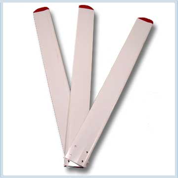

Remember those Chinese blades I modified a few weeks back? Well I've sent them off to David Warren in Townsville for testing. David has the perfect set up to test my blades: lots of wind; a 200 watt Chineese windmill he been running for some time; and a F&P windmill ready to be put into service.
So i packed up the modified blades and my hub to suit the F&P shaft. David has mounted the blades onto his Chinese windmill, and here are his early results in his words.....
"Put them on my Chinese hub and rebalanced. They have been up for 2 hours now and I can already see some difference.
1. slightly negative. they take more wind to start up.
2. up to 200 rpm (visual again) there virtually no sound…….a definite improvement
3. from 200 to 600 it is also quieter probably about 20% in that range
4. however there is still a high pitched whistle that I can hear thru my office window at 400-600 rpm (probably 45 metres)
5. this whistle could also be from the pm motor its self……….did you get any whistle on your F&P?
6. I also believe that mill performs better at the higher speeds but with out a logger its early days "

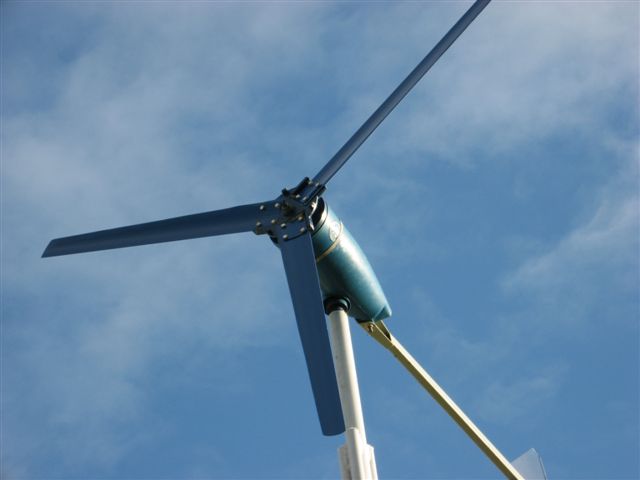

OK here's the latest, plus some photos. Again, in Davids words....
"Hi Glenn,
I will just ramble on and list it as it comes into my head. Observations to date:
Your blades have been up 6 days now
Noise levels are a little high. at higher revs the whistle gets higher pitched and can be heard many many metres away
Still some of the whine is the turbine as I don’t get it on the F & P with Chinese blades.
The reshaping definitely requires a much higher starting speed. However the start up speed here is still acceptable for me. We get wind virtually every day from 10 am till 6 pm and quite gusty.
With the original standard Chinese blades and the Chinese controller I have seen the amps stay between 4-8 and peak burst up to 18-20 amps
Now for the good news:

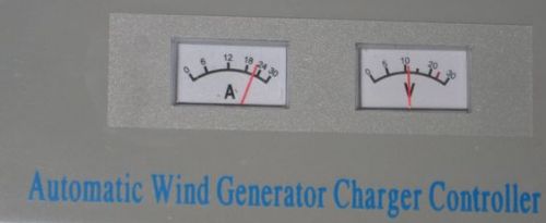

After about 10 in the morning the output with your blades shows 6-12 amp and quite often bursts up to 24 and I have even seen the amps go of the scale at 30 amps………The high end improvement is dramatic!!!!!!!!!!!!! (if only we could get the noise down)
This makes my 200w mill a great little beast.
Have ordered from Trev a tristar 60 amp controller with display and data logging. massive overkill but what hell its cheaper than a set of golf clubs.
That should be here by the end of the week. So I can continue with the f & P s.
Just as you said one bar the hub extender needed packing (about 30 mm out at the tip…. When I finish I will mark that one on the hub and maybe you can give it a tweak.
With standard Chinese blades at 2.5 m diameter and a 5 degree angle of attack the start up is very very poor (decogged 8sp star 12volt)
However if you increase it to 10-12 degrees the start up is reasonable but the output is poor as I can’t seem to get enough speed for a good output
I have to say so far that the Chinese mill works much better than an f & P (going by the number of people who rave over them I must be doing something wrong)
Next month will probably convert to 7 pole cogless and see if I can get these to go.
If you wish to put anything about this testing in you diary forum can you put in my own email warrendj@bigpond.net.au and say if there is anybody in Townsville who would like to see your blades and hub they can contact me and am happy to have them come round"
So there you go. As David said, if anyone is in the Townsville area they can drop him an email to plan a visit.
Looks like the blade modification only helped noise at low RPM, but has given some real gain at high RPM. Davids 200 watt windmill is making over 360 watts.

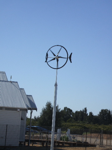

The state government in SA have funded some small wind turbines that seem to have a rotor (fan?) with 5 blades and a ring connecting the ends of the blades I have not been close enough to one of these turbines to asses how noisy they are.

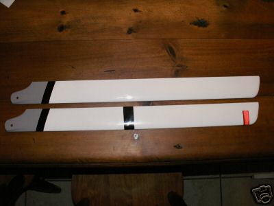

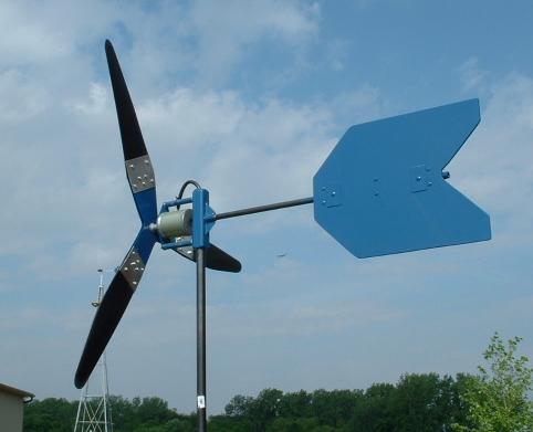

To date, rounded tapered tips like this;
and leading edge rounded off;
have been suggested.
Even a cigar shaped tip. But to date, no trials and no comparisons.

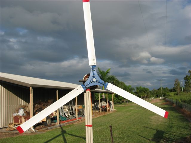

David or Glenn,
What method is used on your blades under test above?
In the photo they still appear square tipped?
I'm fitting Chinese blades now but haven't decided which way to go. Am inclined toward the model helicopter style first then changing to fully rounded and tapered if not happy with noise levels.

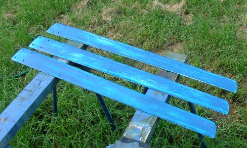

I did round the leading edge of the blades. The problem with blade noise is its very hard to find the cause, sometimes is just a simple change in profile that will either fix the problem or make it worse.
This photo was taken after the first coat of pain and sanding with wet & dry, You can see how I rounted the tips.

Thanks Glenn,
Couldn't see that in the test photo.
There's only one thing for it Glenn, you're going to have to build us a huge wind tunnel, with acoustic monitoring built in. Yehhh!
Cheers Gill _Cairns, FNQ

Just looking at the trailing edge, I see that it is not as fine as I would like. Possible turbulence area???
As a test I'm thinking two strips of say 1" masking tape, one top, one bottom, half inch on the prop other half stuck together.
Simple enough and non destructive.
Then later I'd try much wider tape closer in to the hub due to the ever increasing angle of attack and it's greater turbulence there.
Just a thought.

this is one of the machines installed by the SA Gov
grid connected . I have been told that the performance
has not been good but quietEdited by windman 2007-03-24
petanque don
Joined: 02/08/2006
Posts: 212
Posted: 02:01am 23 Mar 2007
Looks like you drive along Salisbury highway near main north road as well.
It doesn’t spin as quickly as other turbines I have seen
I have never made time to stop and look at the windmill closely.
However it is in a brilliant position as far as the general public seeing a small wind turbine and becoming used to the idea.
