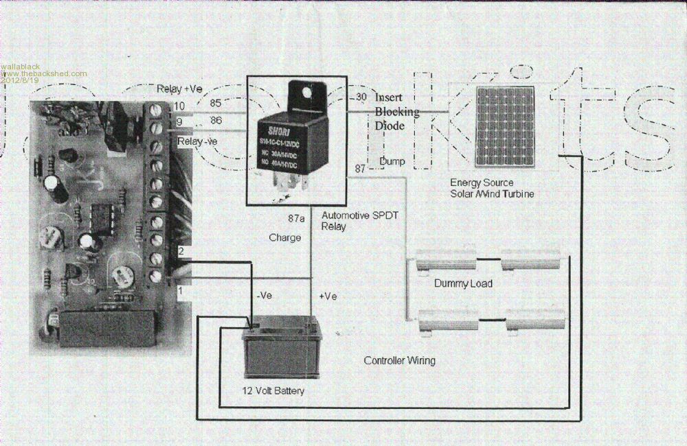

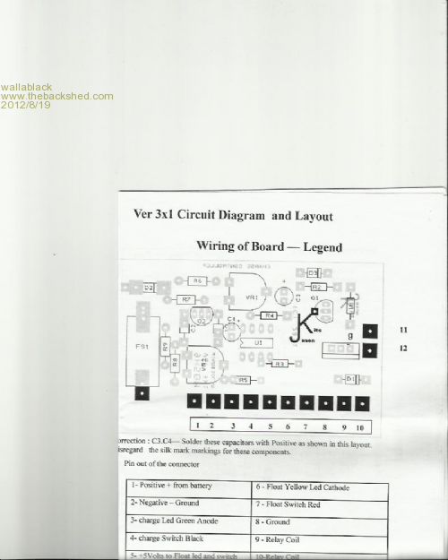

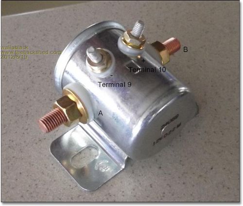

I got a great little charge controller from Jason Markham yonks ago and want to change the 40A Relay to a 100A Continuous Cycle Solenoid/Relay. I have tried to do the rewire in different configurations but none seem to work. It seems such a simple conversion but why am I having so much greif with it. It's not the controller as it has been working perfectly with the 40amp.
Does anyone have any input that could help me with this? What wire goes where? I've confused myself. My source is the + and - from my rectifier of course and my dump load are just resistors as in the diagram but 4 @ 300W which are in one string.
Terminals 9 & 10 (at the top of the picture go to the relay coil, 9 being positive)go to the two small terminal on the front of the solenoid to operate the coil.
The terminal execution.
The diagram of the 30/40 realays use.
The Solenoid.
Help is hugely appreciated.Edited by wallablack 2012-08-20

Hi Wallablack,
if you need us to read the diagrams posting as a gif file will help, the size limit is a lot bigger.
your old relay is listed as spdt (single pole double throw) so the power is always going somewhere, battery OR diversion. The 100 amp contactor is just on or off. the controller is designed to switch power output from terminal 87 to 87a on the old relay.
Is it 12 or 24 volt? I cant tell. The simplest solution is to find a SPDT relay, I do know where you can buy some good ones but the memory has deserted me.
NEEEEED COFFEE
EDIT forgot to mention, there is a fair bit of power going through the relay coil, may need to check that the circuit can handle it (could be up to 100mA) and perhaps consider wiring a diode across the coil terminals if the relay does not have one built in. The voltage spike when the coil de-energises can fry the transistors and a lot of other expensive stuff.
Edited by yahoo2 2012-08-20

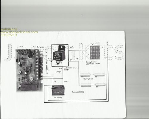

wallablack
Joined: 10/08/2011
Posts: 164
Posted: 07:35pm 18 Aug 2012
  yahoo2 said   Hi Wallablack,
Try this:
Foolproof systems do not take into account the ingenuity of fools.

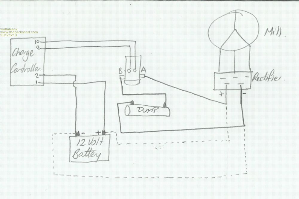

Posted: 12:15am 19 Aug 2012
A to supply V+
B to dump load resistors
9 to controller terminal
10 to controller terminal
Supply V- to other connection on the dump load resistors.
Take note of Yahoo2 comment about the solenoid requiring much greater power to drive the coil than the relay, it might overload the circuit of the controller trying to drive it, so you may be best to use the 40 amp relay to drive the solenoid.
Then you have the problem of powering the solenoid coil and if you use the power from the rectifer it is likely to switch off the solenoid when the dump load is on, hence disconnecting the dump load........not good.
Pete.

Posted: 01:22am 19 Aug 2012
  Downwind said   A to supply V+
Pete.
Soooooooooo....yay or nay?
An IRF540 drives the relay coil so it should be right, it is mounted to a good heat sink too. The regulator will get a heat sink too. I have no doubt at all that the circuitry will be okay.

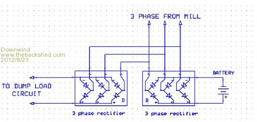

Yes that should work, EXCEPT! the circuit design will dump power from the windmill and the battery, i see this as a poor design because why do you need to dump power from the battery when you have taken all that time to put it there in the first place.
All that is required is to dump the power the mill generates (not the battery as well) you could use a blocking diode between the mill and battery to prevent the battery being dumped, but i dont like this method as it adds a 0.6v drop to the battery.
The best method is to use 2 x 3 phase rectifiers, one rectifier supplies the battery, the second rectifier supplies the dump load, this way there is no added diode loss to the battery system and also prevents battery discharge during activation of the dump load.
This is the system i use and it operates faultlessly, also the dump load runs much cooler because when the mill is dumping its like hitting the brakes and the load pulls the mill rpm down effectively stalling the mill in lighter winds, once stalled it just spins slowly making very little power till the dump load is switched off again.
Pete.

  Downwind said   The best method is to use 2 x 3 phase rectifiers, one rectifier supplies the battery, the second rectifier supplies the dump load, this way there is no added diode loss to the battery system and also prevents battery discharge during activation of the dump load.
Pete.
Do you have a link to a wiring diagram/pic, im interested and curious to see this.
Posted: 05:34pm 22 Aug 2012
I thought is was rather simple and didnt need a schematic.
Doing it this way you might not need that thumping contactor and the 40 mamp relay might do, it depends on the size of your mill and will it produce over 40 amp???

Using a blocking diode raises the cutin voltage to the battery by 0.6v which dont sound like much, but adds up to be a lot of power that could have gone to the battery that didnt.
100 amp 3 phase rectifiers out of china are about $10.00 each so not a huge expense to run 2 rectifiers.
