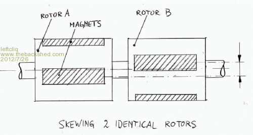

Regarding having two offset rotors on the same shaft to make it cogless. Could I have 2 stators offset from each other and have the two rotors not offset? Hope this makes sense. This way, I don't need to cut and reweld the shaft to make the second rotor offset from the first.
I am wanting to make this and have a 7 phase motor as well.
Any thounghts?
Dale.

  leftcliq said   Regarding having two offset rotors on the same shaft to make it cogless.
I can answer this one...off-setting two motors on the same shaft will only reduce cogging. I have a dual rotor thing in my shed I hacked together with some nuts and bolts. I don't see how cogging will be an issue (although present still) with two motors off-set in the manner you describe.

Hi Dale,
With the last duals that I built , buy twisting the poles and carefully aligning the two stators on the dual bearing hub, cogging was reduced to virtually nothing . It really doesn't matter if you use the GOE 222 blades to power you mill as they will start a dual in under 2.5m/s . Under that w/s there is no power to be made anyway but if the blades keep spinning then they are ready for any wind puffs in low wind situations.
If you are using blades cut from PVC pipe or similar then a coggless F&P may be beneficial as they do not work as well in low wind .
Best combination for a dual is 1 x 100s + 1 x 80S , Twisted poles + cap doublers with a 2.8 to 3m blade set (depending on your wind conditions), this combo was peaking at close to 1kW and produce well in Low Wind as well.
