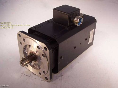

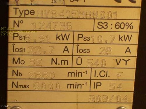

97fishmt
Joined: 19/04/2010
Posts: 77
Posted: 03:20pm 17 Jul 2012
Exactly,
You'll never get there.
So don't worry about it.
From someone that has used servo motors for over 15 years as
wind turbines and never had a failure, I'm only trying to support
their use in this application and how they perform other than a motor.
You wont burn out the windings trying to push power out of one.
Find the right motor and the right rotor for your wind is as perfect
as you can get.
Here is my latest one I'm going to put up on my 65' tower next week.
This one will give the really big one a break. I saw over 1500 watts
out of the big one a couple weeks ago but it just needs a bigger rotor
to get the power out of it.
This one will probably be pushing the limit for a 13' rotor but I'm
game. My furling system works like a charm and easily tunable.
I'll shoot for 30 volts and 50 amps for 1500 watts to start but I'm sure
I can push it to almost 3000 watts. It's line to line resistance is 1 Ohm.
I power an off grid home this way and have for many years.
MikeEdited by 97fishmt 2012-07-19
