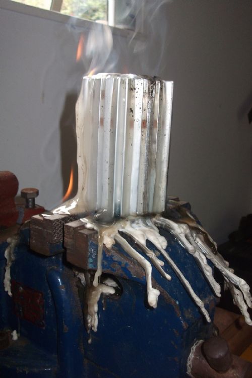

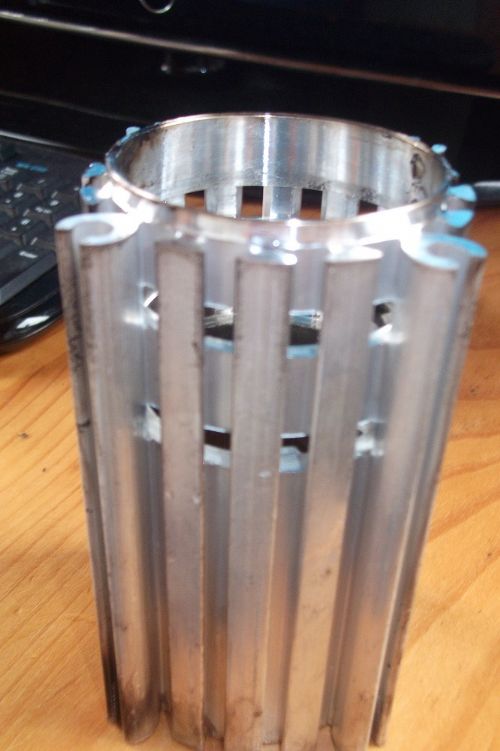

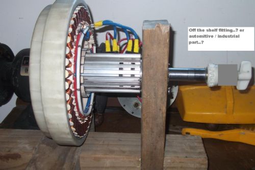

I was thinking about how to remove the the plastic from the shaft then I did something stupid and probably lost a few brain cells in the process.

Actually Steve, that came out pretty nice and clean .. Can you describe what you did,pls.

Posted: 05:42pm 11 Jul 2012
Yeah you should do that outside, the gasses of that would be nasty.
I took it off using a 1mm thick cutting disc in the grinder to get the bulk off them used a old screw driver to punch the wedge shaped bits out.
I am not sure but maybe a hot oven would do the job.
Posted: 04:06am 12 Jul 2012
  brucedownunder2 said   Actually Steve, that came out pretty nice and clean .. Can you describe what you did,pls.
Bruce
Well, looking at the first picture my guess would be a blowtorch
While the result looks nice and clean now it certainly would not be as strong as it was when at least some plastic was in between the alu ribs. Pressing in the bearings might seriously distort the alignment of the two bearings unless the lot is somehow carefully fitted into a new housing first - RHS tubing perhaps.
Leaving the plastic in situ and only shaping it either square or round, depending into what it is going to fit, is a better idea and that is what most F&P windmill builders appear to do.

I have done this a few times, the bearings are not a very tight fit so there is no problems refitting them. Once the whole lot is in RHS tube and filled with resin it is very solid, probably much more than the original plastic. The aluminium must be an alloy as it is quite strong on it's own too.

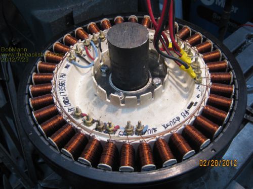

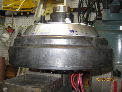

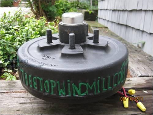

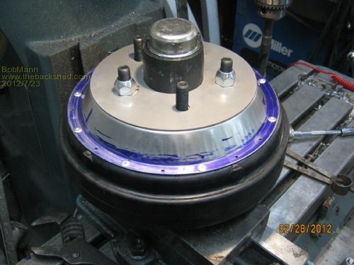

The drum is from a trailer setup you will need to have the drum turned at the auto shop like.050 ths.
But I think you would do better to us this stock Smart Drive setup I build.
Here it is from the side
Here it is from the top
I use the trailer hub with out a brake drum its drag from the bearing is 1/2 the drag of the stock F&P bearings and can be adjusted and regreased over time.
Doing it this way there is like zero cogging with the 60 stator.
Building this way you can swap out stator on the fly with out taking the hub apart.

so my question is, does anyone know of a female fitting (industrial/automotive, whatever) to fit over the end of the shaft?
I had a look at a few of my sockets, they didn't fit properly of course but something along those lines.. or is there anything off the shelf that might fit over it??
BTW whats the correct terminology for the machining at the end of the shaft..?
Stephen
Edited by Stephenj 2012-07-27
Posted: 04:35pm 25 Jul 2012
The end of the shaft has spline on it, a simpler and cheaper way to fit a hub is to use the 25 mm round part of the shaft just behind the spline. You could either use a pulley off the shelf or get a hub machined out of steel. Drilling a hole straight threw the hub and shaft and putting a bolt in the hole and a nut on the other side will stop it going anywhere.
I have used my 1/2 inch drill in low gear to drive shaft directly for testing the generator. Although I found just 1 phase at a time is all the drill could comfortably handle.
BTW you can cut off the end of the aluminium housing where the seal was fitted, this will give you more shaft to work with.Edited by Madness 2012-07-27

Somewhere in this section is a female spline that fits the F&P shaft. From memory(haha,what memory), it's a toyota corolla or something like that .The end of the clutch housing , I beleive.. I once spent 2hours rat ing through a small car wrecker at brookvale on the north shore -he had hundreds of clutches, gearboxes, tailshafts,uni joints --all those have spline drive --go take a look ,but do a search here first.
