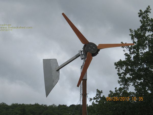

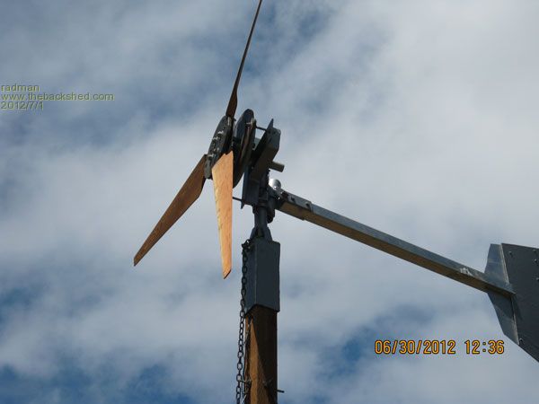

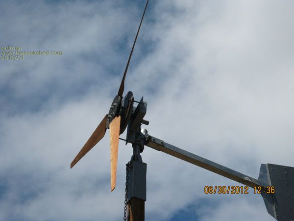

Hey folks, I hope you guys can give me some idea's about what I am doing wrong with this turbine. The rotor spins free but this bird won't fly. I live in a area that has only mild wind and there are to many tree's but I can't clearcut the place for this little mil. I hope the pictures will be enough to let you guy's see an issue I am missing. The blades have a 15 degree angle, is that to much? Looking for an answer.
Thanks in advance, Radman

Hey Glen, first thanks for the reply,I just went out and disconnected the mil from the battery bank so we do get a good breeze here in the late afternoon so I may be able to answer that before I send this. I used Hughes recipe to build this mil. I used 16 awg one in hand 130 turns for a 24 volt. Six coils and nine 1x2x1/2 magnets on a 10 inch rotor, this model has only one disk with magnets. Long story short, I had carved the blades to Hughs spec. Last winter when the ground was really gooey here I attempted to rise it and one of the fence posts I had driven three foot deep just popped right out of the goo. The mil came down and I lost the new blades and the tail. I had made a set of blades out aluminum that some folks warned me would not perform, they did not so I made these blades, they look nice but they are not up there to be pretty but to turn this mil. I have not really found a source that says what blade pitch a blade for this mil should be. I measured the pitch of the those Hughes blades and they were more like 20 degrees at the root.
The wind has went south for the night but I can say I have seen it do 5 volts once or twice with the blades turning maybe 75rpm.

Hey Bruce, it is three phase AC down the pole to the rectifier's. No I can't spin it now, it's 20 feet in the air. The blades and the tail did a good job of breaking the fall and there was no damage to mil. When I mounted the blades just before I raised it, I spun them and I think they turned one revolution. I even backed off the bearing one notch to make sure it was not to tight, the clearance between the rotor and the stator is on the money. I think I have a issue with the blades, the tips finished out at 2" they are 38" long and the pitch is 15 degrees. Is this pitch two much? Can I go longer, say 48"?
