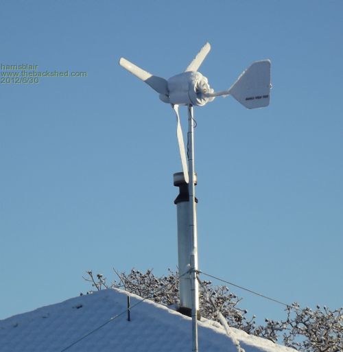

So I've just finished my new F&P wind turbine built with heaps of ideas off this website - thanks. The wind has been good but I'm not making power yet. The cheap controller I got off ebay (which is full of features) seams to be loading it up almost to a standstill. Open circuit the turbine speeds right up as expected but connected to the controller it slows up to an RPM that I know is below 12v.
So do I have a faulty controller or am I overlooking something?Edited by harrisblair 2012-06-30

I ask about the regulator part of the controller because when I did test it on the ground I could feel with my arm that from 0 RPM the controller was loading it, even with no battery connected. So raising the starting wind speed. I thought a regulator would allow it to free spin up to the cut-in then load it up on the battery until 14.3 ~ 14.7V then the internal breaking feature would take over? Its almost like its tricked by something and already breaking.
