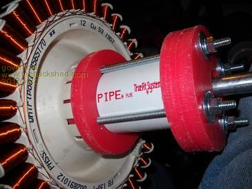

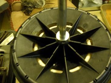

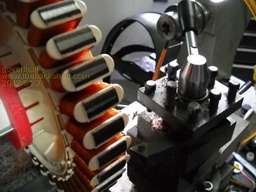

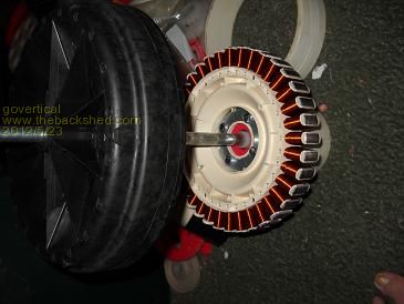

Greetings, I started a F&P PMA project. The stator and rotor are mounted using a similar design that other projects are using. I plan on using the PMA with VAWT blades and a analog MPPT circuit (Buck converter with manual adjusted duty cycle) to charge a 12 volt battery.

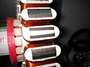

The stator and rotor were a bit off center so I turned down the stator a small amount and now the rotor spins freely without touching the stator, still has small amount cogging.
I heard the plastic of the F&P brakes down when exposed to sun light. Search for solutions. What weatherization is needed for the F&P? Comments welcome
Posted: 02:15pm 23 May 2012
I've had a few F&P stators exposed to the sun and some are OK, some get a bit dusty as the UV breakes down the top layer of the plastic.
Easy solution is to just paint them in a UV resistant paint. This also protects the stator lamination from rust.
Nice work on the bearing housings. HDPE?

Posted: 02:36pm 23 May 2012
Hi, kitchen cutting boards. I think it HDPE. Basically I am using the same design that I used on other projects. I always avoided the F&P because the output was so high. I did not know how to control the output. I learned a lot when I did the buck converter project. I am increasing the input voltage limit of the circuit to 450 volts DC. The new parts for the circuit just arrived and it will me a few days to build the new circuit then I can test the F&P using a drill press.
I will post results when a available. Thanks for info.

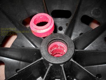

Posted: 04:17pm 24 May 2012

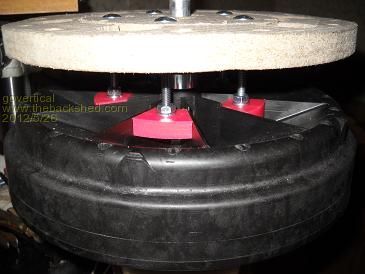

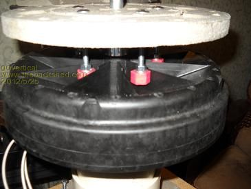

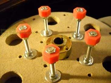

Hi, I needed away to secure the mag rotor to rotating center shaft. I did not
want to weaken the mag rotor by drilling holes in it. My solution was to add coggs to the Blade rotor plate and the coggs will push the mag rotor.

Posted: 01:29pm 26 May 2012

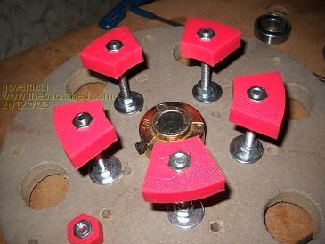

Improved mag rotor coggs

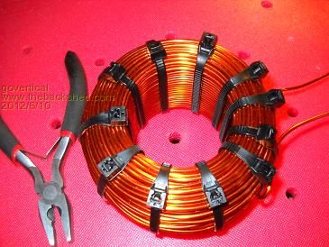

Hi, the last test with the stock F&P I used a 20 amp 400 volt 280 watt IRFP460 N channel mosfet. I made a mistake and I did not increase the inductor value. I recalculated and fabricated a 3.0 mH air core inductor. It weight is 3 lbs with a 2 inch ID center. I used 13 AWG 260 turns. I do not know how well it work, but I will test the stock F&P one more time. The biggest problem at this time is finding a way to limit the input voltage. I am searching for a solution.
Posted: 01:54pm 10 Jun 2012
Do you have a large electrolytic capacitor after the three phase rectifier ?
Without that, there will be some very destructive voltage spikes once the buck regulator starts switching.
That choke looks very good.
Should start getting pretty hot around ten amps.
3mH is a good choice for around 300v (or less) at 20 Khz.Edited by Warpspeed 2012-06-12

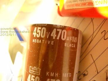

Hi, I several 450 volt, 470 uF caps. Again I not sure how they work. I am having trouble finding large voltage caps. Suggestions for a good value input capacitor are welcome.
Posted: 03:55pm 10 Jun 2012
The bigger the better.
Look at the dc voltage across the capacitor with your oscilloscope.
If there is a lot of high frequency ripple at the Buck Regulator switching frequency across that capacitor, more Microfarads will definitely help.
Just remember, if there is ten amps going into your battery, when the MOSFET turns on, it is going to try to pull ten amps from your F&P, even if it is at up near +300 volts.
Obviously that cannot happen, but ten amps still has to be sourced from the Buck Regulator input capacitor for the very short period when the MOSFET is conducting.
That big electrolytic is a very important part of the Buck Regulator.
It will be constantly being charged by the F&P at low current, but have to repetitively source some very high current peaks during the MOSFET conduction period.

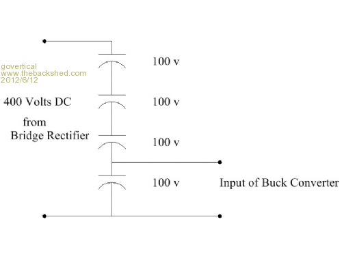

Hi, is it possible to use high voltage capacitors in series to divide the input voltage to a more useable level?
Posted: 12:20pm 12 Jun 2012
No, not with DC. Caps only pass alternating current, not DC current. Plus this type of circuit is a voltage divider, OK for taking measurements or tiny loads, but no good for any real current, very in-efficient.

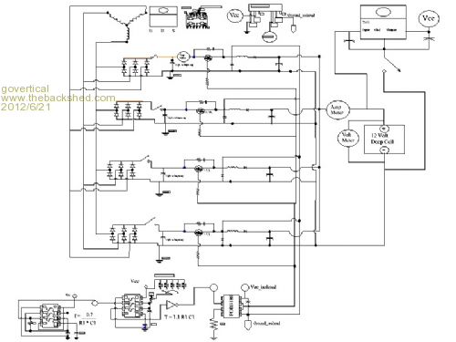

Hi, I completed new concept drawing for the buck converter. Basically it is the same circuit as before. Each parallel buck converter will use a IRF840 n channel and it own bridge rectifiers. Again I am sure if it will work and comments are welcome.
Edited by govertical 2012-06-22
Posted: 03:00pm 20 Jun 2012
That should work.
I would reconsider placing the on/off switch in the negative side of the Vcc voltage regulator, put it on the +ve input side.
Another thing to think about.
If one power MOSFET shorts out, it will likely take out all the rest, because the gates are all joined directly together.
It would isolate any damage if each MOSFET had it's own isolated gate driver.
While that won't make it work any better, it will limit damage to one dead MOSFET, and probably it's own gate driver instead of very likely causing a total catastrophic failure.
With these types of power electronics, it is all too easy for one component to die, and take out just about everything else.
Apart from the cost and work of replacing many parts, it can be just about impossible to identify the original cause of the problem if the whole board is a blackened and burned mess.
If one component dies, it is usually fairly easy to figure out why and do something about it so it does not happen again. Total devastation without knowing what happened can be very demoralising, particularly if it happens more than once. Edited by Warpspeed 2012-06-22

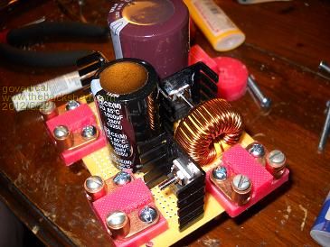

Posted: 05:02pm 21 Jun 2012
  govertical said  I should of said, Again I am NOT sure if it will work.

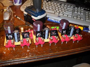

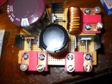

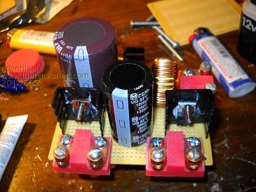

Thank you for the great suggestions. It does make sense to go with a slam dunk. Thanks again. Some photos of the power module circuit lay out.
govertical
Joined: 11/12/2008
Posts: 383
Posted: 02:39am 22 Jun 2012
Hi, making progress. I only have enough parts to fabricate three Buck power modules. It is enough to test with. I still have to route wire connections and fabricate controller board.
