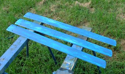

Well I finished the Chinese blade modifications on the weekend. After a coat of paint I sanded them with some wet and dry to remove the fibreglass hairs.

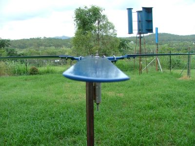

I mounted the blades onto the hub, and jiged the turbine level to get the tips traveling true. Here you can see the finished blade tip and twist.

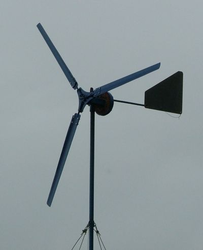

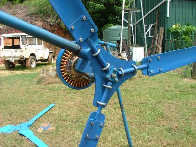

Then mounted them on my F&P windmill. The hub offsets the blades to give a diameter of 2.4 meters.
And finally up in the air.
No real results to talk about, and I dont think I'll be able to get any results for some time, see below. But the windmill started up easily and I saw over 100 watts there for a few seconds during a wind gust. I still need to play around with the blade angles to get the best results. Noise was minimal, there was a low whistle when the windmill yawed.
