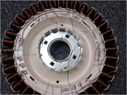

Ok, I'm not new at soldering but nothing I do will get the solder to take to my coil windings which I believe to be aluminum. Can they actually be aluminum and, if so, how can I solder the wires?
I am at my wits end on this one. Please help.
Thanks.
O'yeah, it's a newer F&P with 36 poles. I thought maybe it was just a coating but I took a razor knife and skinned the wire nearly down to nothing and still no copper and it's way too flimsy to be anything else that I can imagine other than aluminum.
Thanks.Edited by greenlivin 2012-04-07

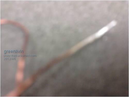

In this pic, I have shaved the wire nearly in half. No copper there.
I was somewhat surprised to pull a whirlpool stator out of a Fisher washer but I 'spose if they put a mitsubishi motor in a dodge ....
Let me know what you think. Thanks.

Have a good look at the way the ends of the wires were originally connected. I bet it was mechanical crimping if it indeed is aluminium wire.
You could try those little crimp sleeves they use on wire traces to fishing hooks. There is even a neat pair of crimping pliers for these available, not very expensive either. Just visit your local fishing tackle shop.
Aluminium wire work hardens even worse than copper so try to keep bending the wires to an absolutely minimum. Once it has gone hard its brittle and might break later on.

After reading your post, I contacted my inside factory guy at the Fisher & Paykel plant in the USA. He said that they wind the stators made in Thailand with aluminum wire and that the plastic stators were marked with the Whirlpool number for a short period of time. The ones made in the US are currently still wound with copper.

Yes, years ago ,way back , I got 2 of those F&P "randy-annie" or something named similar ... They were chunky 6 inch square permanent magnet motors wound with Aluminium .. Huge cogging ,many poles .. I tried different configurations with no success.
The windings were sort of light brown coated, and ,yes, they were mechanically connected to multistrand fly leads covered in transparent heatshrink..
I just removed the enamel coating with a stanley knife and joined them using those strip joiners ..

Yes there is a performance difference with the aluminum windings! That is the reason F&P came up with the new SD4 magnetic hub. It was designed to go on the American (Whirlpool)stators with the aluminum windings to bring the performance back up to the copper wound ones. Which I believe is somewhere between 18 to 20 percent. Randy's Workshop is offering a copper wound stator with the new SD4 hub with the thought of getting even more performance that a stock unit.
