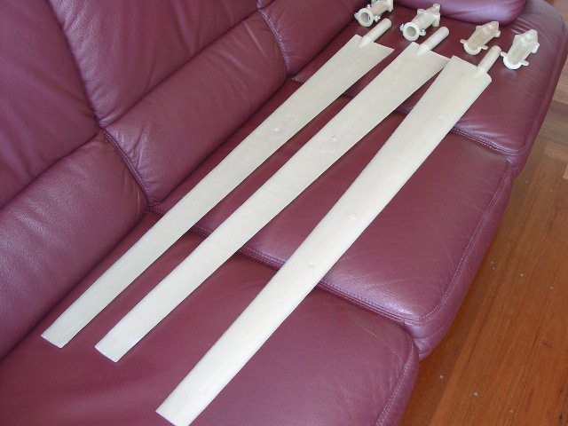

Hi All.
I've started on a page about my modifiactions of the Chinese blades. Its not completed yet, but worth a look anyway. I've finished my blades, just waiting for the paint to dry ( I should have read the can before I sprayed the blades, touch dry in 8 hours ).
So I wont get the blades mounted and tested for a few days yet.
The page address is http://www.thebackshed.com/windmill/articles/chineseblades.a sp
There are no links from the main site yet, not until I've finished the page and have some test results.

Posted: 10:49am 13 Feb 2007
I was surprised how easy it was for the angle grinder to cut throught the fibreglass, like a hot knife through butter and very easy to follow the pencil line. I could see a orange glow inside the cut, but no flame or burn marks, lots of foul smelling smoke though.
I've given the blades a coat of paint, then sanded with wet and dry paper with water, and repainted tonight. This got rid of all the little fibreglass hairs.
