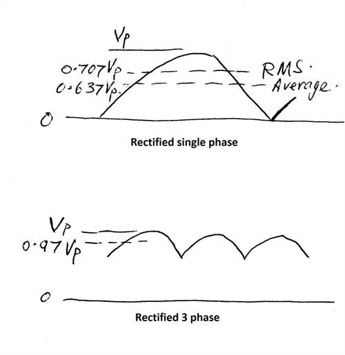

Posted: 03:11am 03 Mar 2012
You are right.
Rectified single phase:
RMS is 0.7071 times peak.
Average is 0.637 times peak.
Rectified three phase:
RMS and average are very close to being the same at around 0.97 times peak.

Posted: 04:54am 03 Mar 2012
A picture is worth a 1000 words. See below.
Len

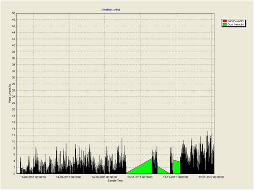

It is currently wired 2 x 7C.
What wiring configuration would members recommend for my wind pattern?
I am deciding between a VWAT or a HWAT.
I have a 200W VWAT at the moment, it doesn't dance around in the wind giving indication the wind isn't very turbulent, the reason for a HWAT is purely for a learning curve.
EDIT: The wind speed on the vertical axis is in m/s (metres per second).Edited by wallablack 2012-03-05
Foolproof systems do not take into account the ingenuity of fools.

Posted: 02:52am 07 Mar 2012
Yes, it shows why the average voltage is about 97% of the peak.
