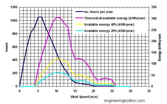

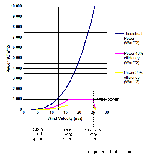

yahoo2
Joined: 05/04/2011
Posts: 1166
Posted: 09:56am 14 Feb 2012
I should have posted this graph as well, it is a good illustration of how small the percentages of energy that is extracted from higher wind speeds are, you can see if the watts of potential energy are multiplied by the 24 meter rotor area, it becomes a huge number, even a tiny amount of lift in a very high wind will destroy a large turbine.
The figures in the graphs are not accurate and are just general examples but I think it makes the point of why this is important for larger turbines.

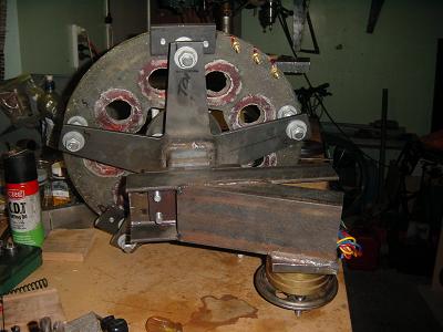

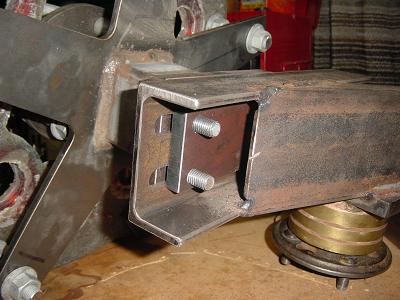

Posted: 11:23am 15 Feb 2012
I am hopless at figures and in the end you will never get furling right the first time it flys!!
this helped me (or just gave me more to play with)
Its an adjustable offset, the tail can also be adjusted just have to take a picture of that for you to see will do that tomorro if you wish.

  shawn said   I am hopless at figures and in the end you will never get furling right the first time it flys!!
I am a little confused now. Is this the same machine being discussed? That looks like a 9 coil stator in the photo, which can't be for a 5.6m machine?

shawn
Joined: 30/03/2010
Posts: 210
Posted: 03:25am 16 Feb 2012
Your comments are corect Chris, my reply I thought would be good in this thread as furling always comes up and science (somtimes) just has to many variables to work with so adding an adjustable mast offset and tail could help.
My early mills I had to cut and reweld them a few times to get it right now I can play it safe.

Ah, OK. When I saw that I liked it and my first reaction was, "Well, somebody knows what they're doing....."
