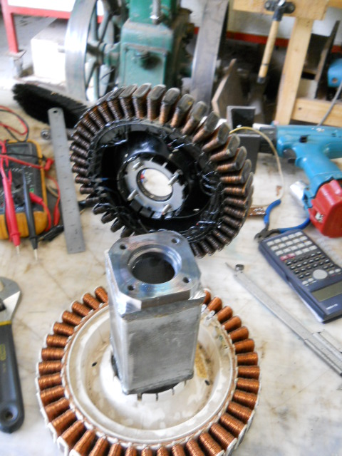

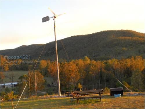

Newbie here. Been lurking for some time now, on and off. I started building a F&P based wind turbine some five years ago and have just this week finally got it flying.
I know it's still not installed as well as it could be as it is currently on the top of an 8 metre octagonal steel light light pole found in many suburban streets but it needs to be twice that height for this location. I have an 8 metre length of 4" water pipe ear marked for the extension.
I carved a set of blades from laminated plywood and then covered in carbon and glass epoxy composite. At 1200mm each I have a 2.4m dia three blader.
The stator is a 60 series rewired for 48volt, (I forget the arrangement as it was done a few years ago but I have the details in the workshop somewhere. It seems to cut in at around 150 RPM or so. The rectifier is three 35 amp 400v bridge rectifiers.

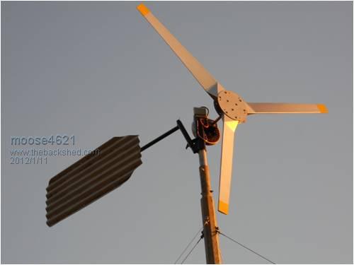

Mean while, I took a couple of shot this evening to decorate this post with as I kow how much I like to see pickies.
The size of the tail is another concern of mine. It was sized according to Hugh Piggot's book but I see most of you guy's have much smaller tails.

Nice looking set of blades you have there! Good work. But your tower is leaning to the left a bit
You can go smaller in the tail, but dont get any closer. The longer the tail boom, the better, it has better leverage and holds the turbine into the wind better.

As for the leaning tower, it was late evening, ie, after rum o'clock and everything seems to lean by then.

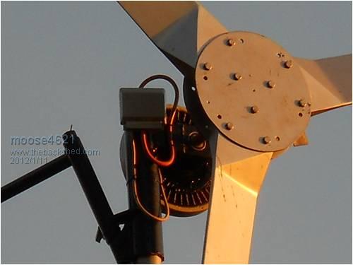

Am I looking at your photo right? There seems to be a lot of unsupported shaft behind the hub. May be something to look at upgrading when you decog the rotor.
