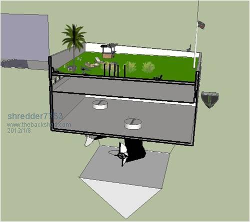

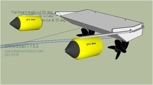

so this is what my test platform for the generators will be like:
heres a cut-thru image of my floating private island design. its called a "Bergstead". I want to make it possible for people to live autonomously outside of any existing nations legal territory.

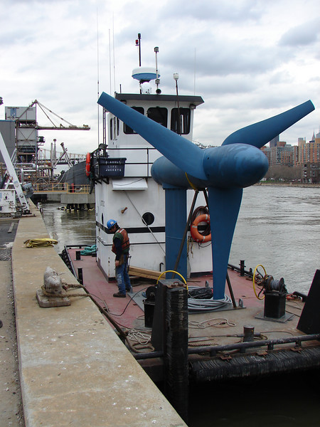

What you are building is called a free flow or kinetic reaction turbine. my guess is without a pipe wall to hold the water in and guide vanes to create a vortex, a lot of the kinetic energy will slip around the outer edge of a small prop and be lost.
There is a lot that can be learned from larger commercial systems. this is a good example from the St Lawrence or East river NY, the prop speed here is 32 RPM but the gain is the water will flow smoothly over the blades with minimal cavitation and stalling creating huge amounts of torque.
image:verdant power inc

I think a large dingy with a nice solid transom and a little outboard motor would make a good test bed.
Home made dynometers are not that hard to make, with a few bits of junk, a spring-gauge torque wrench and a handheld rev counter!
