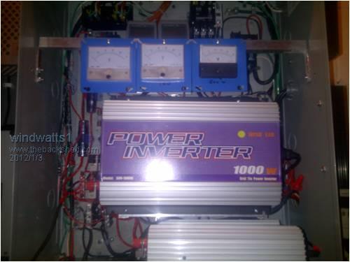

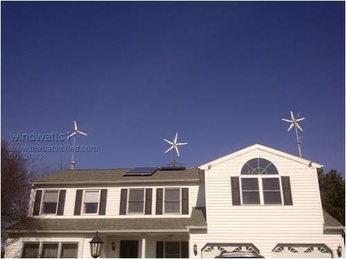

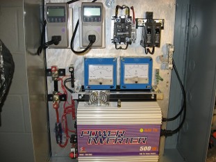

I am electrical contractor from Pottstown Pa. I install electrical, solar, and wind systems. Since i have gotten into micro wind in the 1kw class and under i have been trying to grid tie for two years. Not much on the market for 24v turbines, LOL

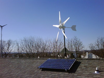

UL inverters is not worth the money to me for what i have in wind so i thought i would take a crack at the China ones. Well, since the Sun G wind rated ones came out i have had some great sucess with them. Using 3 Wind Max 24v turibnes HY 1000, HY 600 and the HY 400. I have made a nice little control system for them to operate to the grid. I have made a custom roof mount bracket for my 1kw which has been installed for two years now as well as custom side of the house pole mounts. Since i live in a residential area i had to find ways to accomadate what i wanted to do in a small space. It's been a long road to get where i am considering i could not just stick a 5kw up and be done. Some of the pics are older and some newer. Please enjoy and thanks for looking.

Thats a very nice set up windwatts. The windmills look good on the roof. Good work.

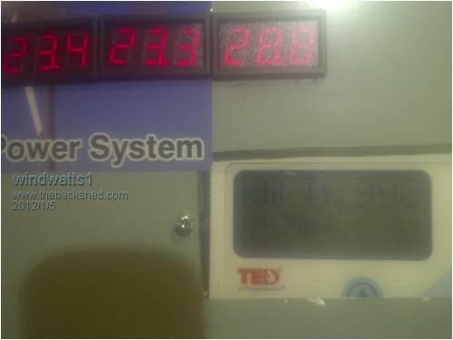

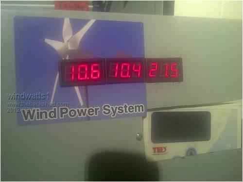

Here is a pic of my system with digital volt meters and a TED energy unit to measure he AC watts comming in. This was last week (12-29-11), 990w, made 3kw that day (24hrs). Not much but all in fun of course. I am looking to get about 2,100w again if he winds would agree.
