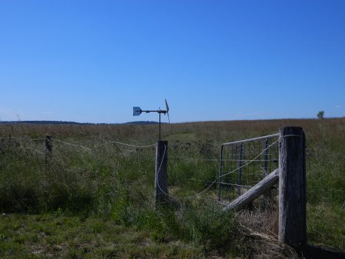

Well I have the land. Still waiting on the house and shed. Wanted to make my mark, start the ball rolling, do something symbolic of things to come. So I put up my first wind turbine at my new home.
This one has a 30mm diameter all PVC turbine ( cut from some PVC down pipe ), direct drive to a DC generator ( motor from a old printer ). Output is shunt regulated ( 8v zener ) and drives a incandescent lighting plant ( 6v torch bulb ). The tail is aluminium ( from a cut up Coke can ) and tail boom in treated timber ( pot plant stick ), and ballanced ( with a 12mm bolt zip tied to the boom ).
I expect a massive 0.5 watts from this rig.
It actually felt pretty good to see it spin up after I mounted it to the fence post.

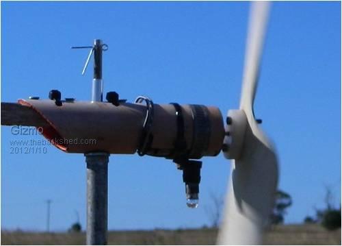

I made the hub from a little block of HDPE ( kitchen chopping board platic ). Its about 10mm thick, 15mm wide and 40mm long, with 3 holes drilled in it. The PVC blade was screwed to the outer 2 holes with self tapping screws, and the center hole is a pres fit over the little motor shaft.
I was there yesterday and very happy to see the little windmill spinning like crazy, and its little lightbulb still working.

We're only talking about milliwatts here, a press fit into HDPE is more than enough. The shaft on my motor was only about 2mm too. Found a photo, its actually an older hub, this one uses tiny metal nuts and bolts to secure the blade to the block instead of self tappers, but its still a press fit onto the motor shaft.
From memory the hole was about 1.5mm or so, a nice press onto the 2mm shaft. If you cant drill a hole thats a neat press fit, you can go bigger and drill another hole in from the side that intersects the shaft hole, and screw in a self tapper to hold the shaft in place. HDPE is very elastic, a brilliant material to work with.

I like it, I have been spending my work day not doing work and have a few new ideas.
I will definitely try your push fit, I just thought that the constant movement would cause it to expand, oh how wrong was I.
Thanks for the pics, helps a lot.

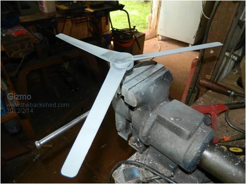

Well the little windmill threw a blade. Broke clear off, left with half a turbine. I'm guessing a sudden furl at speed did it, and this is a typical problem with two blade turbines, there is a lot of stress in the turbine when the windmill furls to a new direction.
The best way I've heard the problem explained is like this. Take a broom handle, or any long stick, and hold it in the middle. Now hold it vertical, up and down, and turn yourself around on the spot, like a windmill furling. Easy. Next rotate the stick 90 deg so its horizontal, out to each side of you, then try to rotate on the spot again. The stick will resist, and you need to hold it much tighter. Now imagine this stick was spinning around, like a turbine, and you try to rotate on the spot. You will feel strong pulses in the stick, as it rotates through horizontal and vertical position, and in a windmill these can break off blades and shake just about everything above ground level.

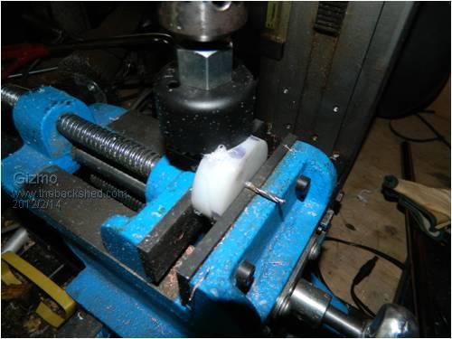

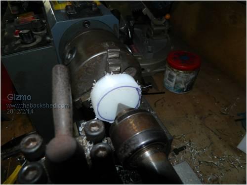

The problem is non-existent with 3 blade turbines, they have a natural balance. So I decided to make a new 3 blade turbine, just for fun. First I machined up a bit of HDPE.
Then used a hole saw to cut 3 slots at 120 degrees.

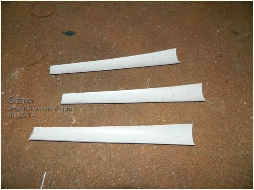

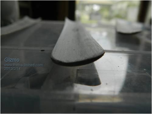

Cut 3 blades from some 40mm PVC pipe.
And reshaped to get a nice airfoil.

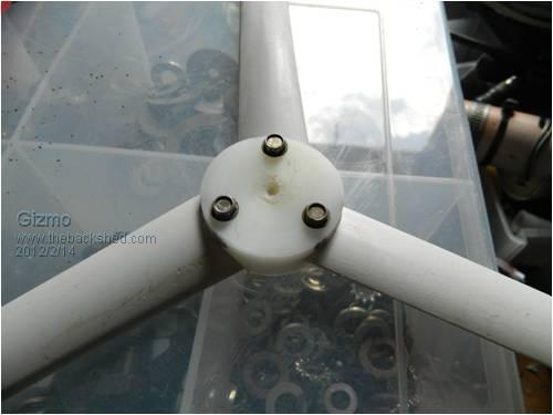

Fitted to the hub, held in place with some metal screws.
Finished turbine. Coat of paint to help block UV.

Nice pics.
I like the idea of notching an extra thick hub to allow the blades to sit in it.
