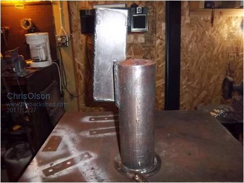

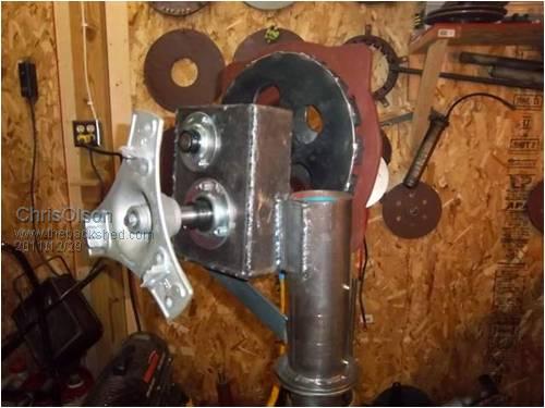

I'm building a new machine with a 3.2 meter rotor driving a geared three-phase ferrite axial gen designed to run at 100 volts on a 24 volt system with a Midnite Solar Classic 150 MPPT controller.

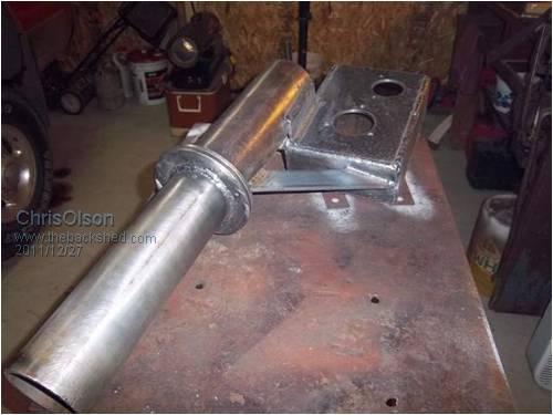

This is a few photos of the project. I built a new gearbox and head for it. This gearbox has a .400:1 ratio (2.5x overdrive)

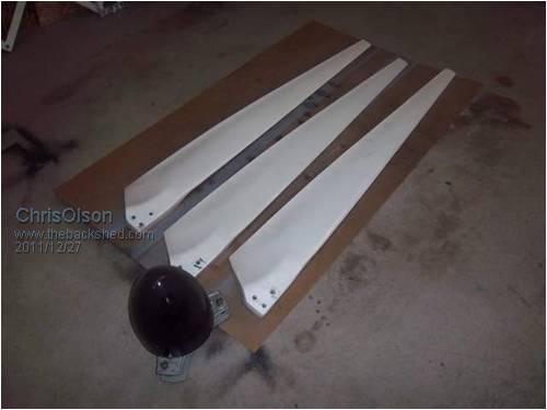

This is the blades I'm using on it - these are glass blades with a S809 airfoil

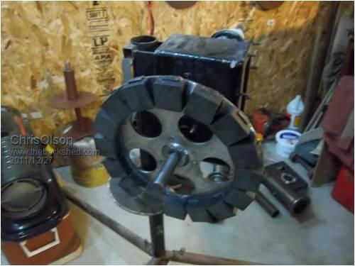

The gen is 16 pole using 51 x 51 x 25 mm thick C5 ferrites on 355 mm rotors - in this photo I was checking the balance of the rotor on my test turbine head by running it up to about 2,000 rpm. The gen will cut in at 250 rpm (100 rotor rpm) and reach 117 open volts @ 1,000 rpm (400 rotor rpm).

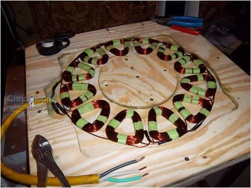

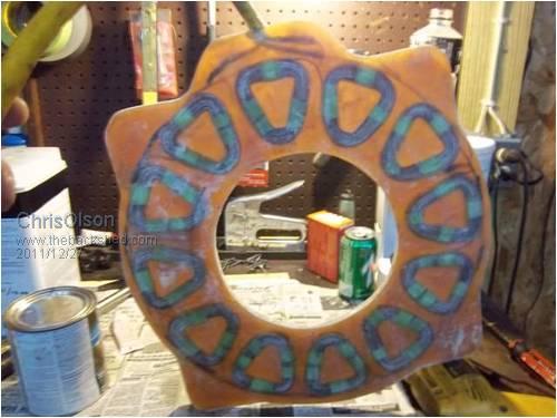

This is a couple photos of the stator for it - 12 coils, 45 turns of 13 AWG wire, .55 ohm internal resistance, wired wye
At 100 loaded volts to the controller @ 1,000 rpm (TSR 5.6 @ 12 m/s) the generator will develop 3 kW ([117-100]/.55 = 30 amps) @ 85.8% efficiency.

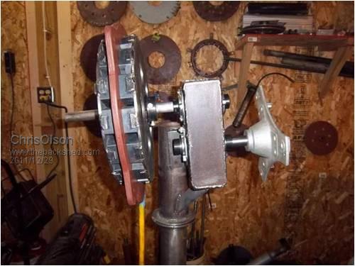

Well, I got the head test assembled and the stator clamped firmly between the gen rotors so I can build a stator support for it

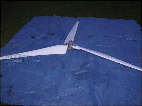

I'm trying to picture in my mind what a 3 foot diameter rotor like that would look like
As someone else pointed out, the rotor diameter on this machine is 3.2 meters, which is 10.58 feet..
This is one of the smallest turbines I've built in quite awhile. I selected that size because the output of the blades is matched well to the controller. And I just happened to have that set of blades in a box on the top shelf for the last two years.
This is a photo of the rotor that's being used on the turbine, taken a couple years ago when I removed it from a different machine

As for the gearing up work you have done with this build and taking the time to make a gear box and mount what I would think would be straight cut gears is well worth the effort for longivity and safety rather than taking the easier option of belt or chain
The geared drive in this one is oil bath roller chain. The oil bath roller chain drive has proven to be much quieter, and much more durable than gear to gear drives in my previous geared turbines.
There's a reason that oil bath roller chain drives are used in severe duty applications like motor grader final drives, skid steer loader final drives, engine camshaft drives, 4 x 4 truck transfer cases, and so on. The roller chain drive is just about zero loss in transmission of power, with the only loss being the friction between the pins and side plates on the chain. I have a couple turbines that have over 12,000 hours on them with the oil bath chain drive and the chain and sprockets were still like new the last time I had the turbines down to service them.
I'm using a 30 tooth drive and a 12 tooth driven in this machine, with the driven gear being a hardened chromemoly sprocket that I got from McMaster-Carr. The chain is a single row pre-stretched ANSI #40 with stainless pins and side plates, brass bushed rollers and the rollers are hardened 4140 chromemoly steel. I got the chain from McMaster-Carr too.
Gear to gear drives create a lot of heat (and hence higher gearing losses). They are better suited to designs that require very close shaft spacings (such as in automotive transmissions). But you can't run gear to gear drives on shafts supported by ball bearings because the bearings develop a small amount of "play" after they break in, which will quickly destroy the gearset. With gear-to-gear drive I'd have to use tapered roller bearings running under preload to maintain the long-term backlash spec on the gearset. And then I'd be dealing with high losses in the gearset and high startup torque to turn the bearings.

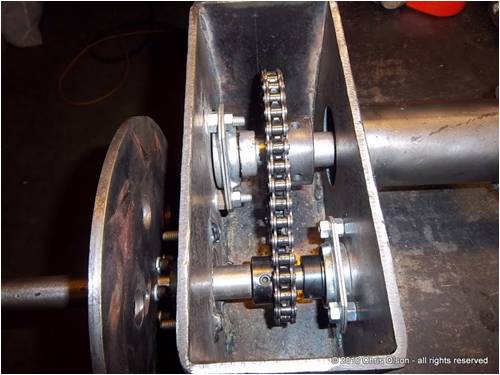

Hope you don't mind Chris. I found a photo of one of your previous boxes on my computer that shows spherical bearings with concentric collars and chain drive beautifully.
There is a huge variety of flange cartridges, sprocket centres and bearings to chose from. this is "bread and butter" engineering for manufacturing in agriculture. Done correctly with quality parts, its very robust and easy to repair.
yahoo
Yes, I just uploaded a video to my YouTube account last night of the new machine - I will have it finished today and ready for the tower with just a few minor details like the generator cover to keep water and snow out of the gen, electrical junction box, etc:
http://www.youtube.com/user/OlsonFarms#p/a/u/0/9hR_Kc-nJPI
I used SKF (my wife is Swedish so I have to use those SKF bearings ) extended race angular contact ball bearings rated for both high axial and radial loading on the mainshaft. The PTO shaft has normal SKF ball bearings rated for high radial load, and 50% of the max radial load on axial loads.
The photo you showed was my prototype drive and I have made several changes to them since then. On the prototype I installed the pilot bearings inside the case. On the later ones I have gone to thru-shafts and align-bore the case bearing bores. This makes it easier to assemble and service the gearbox and provides better accuracy and alignment on the shaft centers.
On some of the later gearcases I have built, I set the shaft centers slightly closer than nominal, allowing a little "slack" in the drive chain. Then used a snubber block, or idler, to adjust the chain backlash. On the last three four, including this one, I have gone away from that too because it's unnecessary. If the shaft centers are set properly, the roller chain will run for 20,000 hours between replacements with no adjustment required. It's very similar to the Detroit V-8 engine timing chain drives used for better than 50 years.
