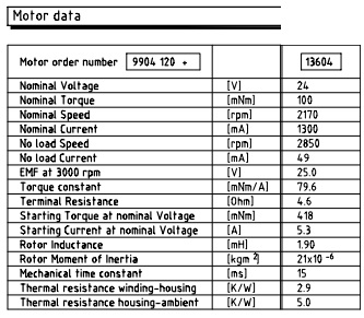

The generator that we will be given to use is a Premotec DC Coreless CL66-25 Watt Motor. As far as i'm aware it will be the 24V motor which has the values of:
Datasheet:
http://www.premotec.com/pdf/coreless/CL66-25%20Watt.pdf
Further Data provided:
2011-12-02_062210_Power_Management_24V_Motor-generator.pdf

Returning to the matter of the PMA, the data that you supplied shows that it could output 25 Watts or so, but would need a shaft speed of over 2,200 rpm to do it. This is the problem with small diameter alternators, as they need to spin at this sort of speed to produce anything useful. This is why larger wind turbines are directly coupled to larger diameter axial flux alternators that don’t need to turn so quickly to produce power.
It is also instructive to inspect the “Electrical Output Power” curves that you supplied. While these are labeled for a “Trident” generator, I assume that it would be quite similar to the CL66 25 Watt 13604 motor data that you supplied. I note that they only tested the motor down to a 12 Ohm load, and yet the CL66 terminal resistance is quoted at 4.6 Ohms.
As noted in my earlier post, the maximum power transfer occurs when the load resistance is equal to the generator winding resistance, and this would need a load down to 4.6 Ohms. Had this generator been tested down to, say, 2 Ohms load resistance, then the output power would have been seen to peak at around 4.6 Ohms, and then again decrease. It would be interesting to get the tests re-run in this way, as then you could see the actual maximum output power.
You note three test wind speeds of 5, 10, and 15 m/s. If you selected a 3 blade turbine with a TSR of 5, your turbine tip speeds would therefore be 25, 50, and 75 m/s. If you use the full 400 mm diameter available to you, then your shaft speeds would be 25X60/0.4 Pi, or 1193 rpm, 2387, and 3850 rpm. The first is certainly in the band of being useful, while the others are too fast. If you went for a 6 blade turbine, with a TSR of around 2 to 3, then the respective turbine shaft speeds would drop to half of the above values. Note though, that there would also be a turbine efficiency loss.
Note also that the shaft speeds are only part of the picture. What you now need to do is to go to a “Power in the wind” site, and look at what power you can get out of a 400 mm diameter turbine at the 3 velocities in question. As previously noted, you will probably be looking at an efficiency of something below 30%. The power available at 5 m/s will probably be quite disappointing but, above that, the cube law for power vs velocity will make it much more useful.

Incidentally, you mention that a previous team achieved 18 Watts at 15 m/s, so that you should have plenty of upside Watts available if you are prepared to apply proper design principles. You also mention that they had a calculated efficiency of 8 to 9%, but I wonder how that was calculated, in particular, where did their power input figure come from?
I suggest that you use the full 400mm diameter available to you, and carefully design a 6 blade turbine for a TSR of about 2.5.
