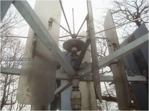

The Vawt worked better then I thought it would I am totally off the power grid.
The output voltage is steady at 26.3 - 27.7 volts dc on the 24v side after rectification with a 2-12 mph wind. I charge into an ultra-cap bank using the wind to charge this power source using charge equalizers installed between each ultra-cap bank to charge from the wind and have a stable output depending on how many ultra-caps you use you can obtain an output with high amps and watts. I use 36-2600uf ultra capacitors recycled from the electric buses when they upgraded to 3000uf. I am charging the battery storage banks that are recycled forklift batteries from part of the output of the ultra-cap banks. I also us a bank of ultra caps before entering the three inverters that are used to power the house. From the batteries to the inverters I again enter a boost cap bank each cap is 2500f at 8000 joules, there are 6 banks with 6 caps in each bank. This gives the bank of inverters a stable current input to handle multiple start-up loads and places less of a strain on the battery cells.

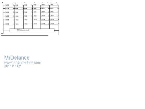

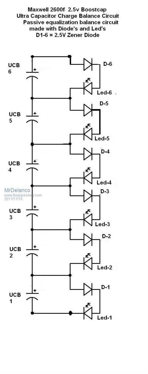

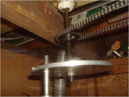

I use the cycloturbine to generate the motion to run the 1st alt-generator. From the 1st Alt-Generator the output goes into a bank of four(4) full bridge rectifiers. I rectify the voltage and charge a Maxwell ultra capacitor bank setup to 24 volts. From this I enter the charge controllers that charge three banks of 24 volt wet-cell forklift batteries. From this battery bank I use a bank of Maxwell ultra capacitors to run a 2nd Motor-Generator-Flywheel pma that charges a bank of 36 Maxwell ultra capacitors "Boostcaps" before entering the charge controllers that charge another battery bank of seven(7) 12 volt forklift gel-cell batteries. From the 12 volt batteries I use another bank of 36 Maxwell ultra capacitors "Boostcaps" before entering the inverters that are used to power the house. Each Maxwell ultra capacitor is 2.5 volts 2600f at 8000 joules, there are 6 banks with 6 caps in each bank to build a voltage of 15vdc. This gives the bank of three(3)10,000 watt inverters a stable current input to handle multiple start-up loads and places less of a strain on the battery cells. There are two(2) more 6,000 watt inverters that run my lab and workshop. and another 6,000 watt inverter to run the computer rack.
To keep the Maxwell ultra capacitors "Boostcaps" from charging over 2.5 volts I built a charge equalization circuit for each row in each bank.

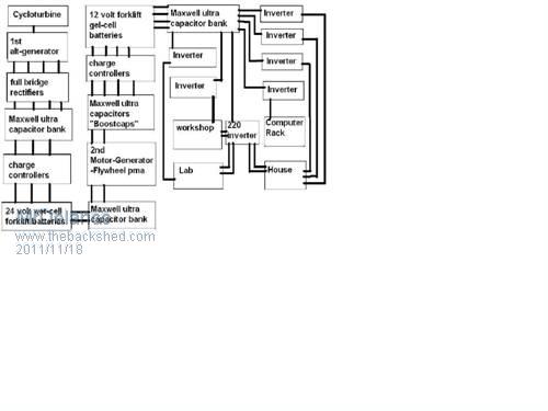

Here is a block view of the setup.

I like the way you have the Vawt set up, a big slow spinning mill with a shaft through the roof with all your gearing and generating system in easy reach for maintance and lubricating it all looks to be running like clock work.
That is the way I always thought a big Vawt should be set up.
It is good to see that you have taken on something this size and made it work.

Wow, that's a lot of steps. Aren't you losing power at each conversion/storage stage? How is this better than running alternator-rectifier-battery bank-inverter?
What function does the second motor and flywheel serve? And all the ultra caps. Those are all energy storage devices. Why have 3 different types in series generating heat and wasting power?

Hello Perry;
It is not a lot of steps for a complete electrical power generation setup for my home use.
I have found no lost power at conversion only increase's in amp's and watt's.
I am running alternator-rectifier-battery bank-inverter but with two systems combined.
I only require a low 2-12mph wind speed to keep the storage batteries charged and the system in motion.
The function of the 2nd Motor-Generator-Flywheel pma is described in a past post. Understanding the wind stops from time to time the 2nd compensates for times without wind by providing a ups input.
The motor/generator draws power provided by part of the 1st battery bank to spin the rotor of the flywheel. The kinetic energy stored in the rotor is transformed to DC electric energy by the generator, and the energy is delivered at a constant frequency and voltage into the storage system. This also helps to prolong the life of the batteries.
The ultra-capacitors provide strong steady power. By combining ultra-capacitors with a battery-based uninterrupted power supply system, the life of the batteries can be extended by reducing the cycling duty on the battery cells.
I have found no heat being generated and have an abundance of extra power.

I think I understand now. You are using 3 storage methods, batteries, caps, and a flywheel. Then again, maybe I don't understand by looking at your block diagram above. Are all those things connected in series? Sure your flywheel provides energy when the wind isn't blowing but that's what the batteries are for. Man your recycled parts bin must be nice. Aren't Maxwell Ultracaps and flywheel backups UPS's expensive?
I like your videos. Since you asked, I build smaller turbines just as a side hobby. Have a couple I 'fly' in my garage since it seems I get absolutely no wind at the house. Frustrating for sure.
I'm curious why you use a LED and a zener. Is the LED telling you when the cap is fully charged?
BTW, I enjoyed watching your super cap video, unfortunately these are a trifle expensive to start experimenting with and recycled ones are not available AFAIK.

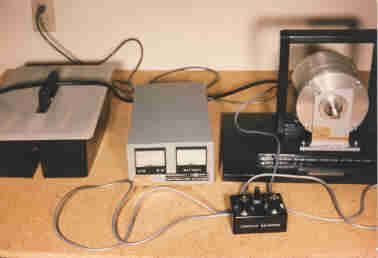

Here is a Tid-Bit of information.
About 35 years ago, Fradella and two of his brothers who owned a machine shop developed the brushless regenerative DC motor shown below. Fradella very successfully demonstrated it to colleagues where he worked as a consultant, at the Navy weapons development center and at Hydropower in San Diego, also JPL and Aerojet; each issued purchase orders for various diverse applications. It was also demonstrated at Parker-Hannifin. Fradella was not able to finance motor manufacturing, and therefore could not accept the motor purchase orders.
The left photo shows the portable motor demo, with its 48vdc battery pack, power interface electronics (including a plug-in battery charger), the motor assembly, and user control box. The next photo shows the motor prior to assembly, with its rotor and stator disks and supporting parts.
RPM's brushless regenerative ultra-efficient DC motor.
This motor technology is closely related to the DC generators and flywheel batteries, plus the RPM EV motor-wheel developments that followed.
It is tested and proven.
Source Info
For a quick visual scan at the panel, and to indicate when the ultra-caps are charged or that they are charging.
Perry
Hi Perry;
My system is comprised of several sub system's combined into one.
There are several sources of recycled parts available too me. I have quite a few friends in several area's that stay in contact with me and what I am doing, they are always asking for my help and always offering items too me.
The Maxwell caps came from public bus upgrades and I purchased them from Electronic goldmine's online store, by buying 100 of them I got a better price per unit.
The Motor-Generator-Flywheel ups unit is an integrated component of my system and uses part of the earth's rotation to assist the flywheel's rotational motion this was a plus. It took me awhile to build the unit and getting it to work on a smaller scale took considerable inventive research on my part. Material strength has increased over the past decade and is found in all types of recycled items. Permanent magnets like Neodymium are up in cost, but I had bought my supply 3 yrs ago when they were cheaper, and by using smaller magnet's and improvising other components I was able to produce a working unit fairly cheap in cost.
Flywheel Basics
I setup my system to be supplemented by the wind not to totally rely on the wind.
I also have 12 230 watt solar panels that charge and run the 24 volt side of the system during daylight hrs.
I find I enjoy teaching the science of recycling to others.

  fillm said
I would think they would need to be in paralell or you would risk turning those caps into loud exposions.
Did you design the Cap balance circuit?
I know enough about electrical circuits that there will be no explosions.
The balance circuit is a standard design available from several sources, I customized a circuit design to meet my needs.
