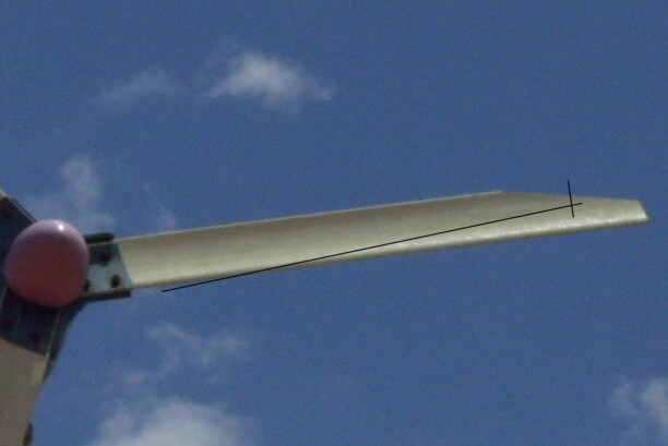

I have a commercial (well, nearly. Chinese job) 1KW turbine but got a $&#%*(*%# noise complaint against me yesterday.
Council are checking, but I want to know my options.
These blades are 3m dia, fibreglass. No twist, no taper, but they do have a little taper over the last bit of the blade only.
So, Ideally, I want to find someone who has or will make at modest cost, a set of full twist, low-noise blades I can bolt to my existing hub. All I know is its a 3m dia, nominally 360 RPM.

What are the blade tips on your blades shaped like, you could try rounding them off.

Closeup of one blade. Sorry its so noisy, the damn thing was spinning, so I had to set the shutter as fast as I could to stop the blurr, and in order to see it side-on, I had to be at a pretty fair zoom, so its sadly lacking in light now :(
And here's the whole thing: (same apology about image quality). (The black tape on one blade tip is simply so I can identify "a" blade - to monitor its stopping position to check for static balance over time etc)

Ummm.... you're saying angle the leading edge?
Yikes, these things are 3/4" thick, possibly more just back from the leading edge, and a metre and a half long! I doubt I could cut them straight, let alone put a decent and uniform radius along their length - and then goodness knows how far out of balance they'd be!
I'm pretty confident I'd bugger them up and have nothing. I might be prepared to try it if I had another set to fall back on, but at the moment I think thats out of my league, Glenn.
You suggested "rounding off" the tip? Leading edge? Trailing edge? Both?

As for the noise, a bloke from westwind told me if you want to make blades quiet place tips on the end like on a 747 wing, apparently they do this on the monster turbines they install. His opinion was the theory should work with small blades too, but he never tried it.
It shouldn't be too hard to fabricate something that would fit the end. He did say to make the leading edge very sharp.
But with no twist there will always be issues that cannot be overcome.
