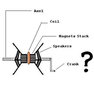

It's difficult to picture what you have, this is what comes to mind for me so I know I must be missing something.? I have included a little help for Uploading pictures,
Remember only JPEG or GIF picture format will upload to this site,, and Pictures should be cropped to the subject view, this will hold a better resolution when the web site re-sizes your pictures.

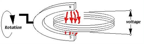

Here's a little picture to facilitate what I'm talking about so you'll better understand what I'm saying:
Study this little picture just to get the idea of how a current is "induced" into a moving wire.
The wire can move or the magnets can move; doesn't matter. There just needs to be movement.
"Force on Wire" means "direction wire is moving through flux pathway."

Yeah we would need some pictures or diagrams to really see whats going on. But one thing to check, the coil inside diameter is bigger than the magnets outside diameter. For example, if the diamter of the magnet stack is, say, 50mm, then the coil needs to wound on a 50mm former, so its finished inside diameter is 50mm or bigger. Any loops of copper wire that are smaller will be cancelled out, to some degree.

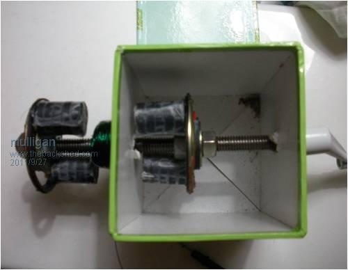

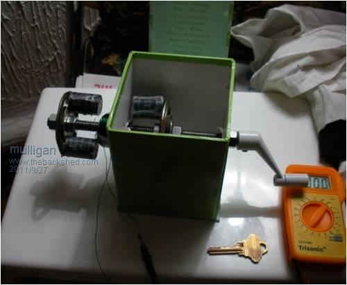

Good looks, fellow backshed members. Your timely and detailed responses are encouraging, especially in my frustration. Here are a few pictures of how it stands now,
The magnet-stacks on the outside speaker are both south side faced out, the magnet-stacks on the inside are north side faced out. Is this the way to do it? Or have each speaker with a N and S magnet facing out and align the two speakers accordingly? I will make a coil with at least 500 turns and make the inside diameter of the coil bigger. With so few magnets, will it help to have more than one coil? If so, do they need less turns? And when I connect more than one coil, do I just connect them in parallel?

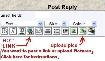

Try the link and image buttons
The forum has tricks to break links unless entered correctly. It reduces spam.

Anyways, at the bottom of the "Post Reply" box at the bottom of each page here. It's what I'm writing your reply inside of right now. At the top of the box, there's a picture of a tree with a blue arrow pointing up. If you click on that box, it brngs up another with a "Choose File" option. I like to drag my pictures to the desktop before I do a reply. That way they're all in one spot. Anyhow, just take it where it has to go and click on it, then hit "Ok". It takes from a few to several seconds for the system to upload your photos, but then they're there for all to see.
Another way, as you've attempted, is to leave a link. To do that, click on the blue "Forum Codes" button and then click on this: URL=http://www.myWeb.com]My Link[/URL
I've purposely left off the beginning and ending brackets, so the code will print and not create a blue hot link that leads nowhere. To use this, they'll each have to be left on. All you do is replace the source code by highlighting it with an apple-x (for Macs) and then highlight the link's source code and replace it. Where it says "My Link" just replace that with a word or two that identifies what you're doing like, Picture or Link or whatever. That way, folks can just click your link and see whatever it was you put up for show 'n tell.

OK, looking at the photo, is the coil around the threaded bar, or out to one side?
If its around the threaded bar, then the wires are in direction of rotation, so the magnets are passing along the wire, not across them. As Mac pointed out above, the magnet needs to pass over the wires at 90 deg to the wire.

nice machine !...pics are working fine
mini axial alt then ..
maybe a square bigger coil that has it legs directly between magnets would work better
(or) wind a mini coil that fits directly two poles ...

The coil is fixed to the outside of the cardboard box and DOESN'T rotate when the threaded bar is rotated. I essentially used the box as the stator.

Mulligan, if those are speaker magnets then I suspect their magnetism is directed toward each other (across the threaded rod) and not at all towards the coil as you mounted it. IOW, it won't work the way you rigged it .
Try to relocate the coil so that it is inside just one rotating pair of magnets - leave the other pair off - to prove me wrong or right. It must be inside so that the whole coil is parallel to the rotating magnets and not with the rod through the coil center.
Not really easy to do I should think, can you instead take the magnets off the backing plate individually and experiment then? First I would find out which sides of each individual magnet strongly attract each other and mark them with paint. Then I would mount the magnets on an iron backing so that the non marked sides stick to the iron and the marked sides face each other (the iron might be the inside of a piece of pipe if my guess is right). If you then locate your coil inside the faces of the marked magnet sides - so that the magnetic lines between the magnets pass through the coil center - you should generate AC voltage when the magnets are rotated,

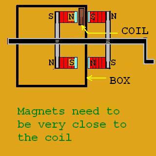

heres another design mulligan.....
mini radial
its radial in layout but uses one coil so is similar in that way to your original
idea ....its an interesting alt i think

Very nice rendering of my contraption. I had my magnets aligned as such, although the coil was placed differently; I had made the coil the identical size of the rotors diameter, so the magnets were spinning along the circumference of the coil throughout their rotation. Could this alignment have caused the "cancellation" effect I was previously warned of? With the coil set off to one side like you rendered, should the magnets pass through the center of the coil or along the outside "legs" of the coil?
PS Please correct any terminology I misuse
