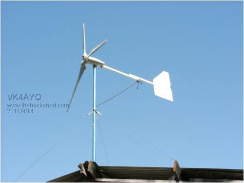

Hi old mates mate
I use a bungee tied to the tail as it lets it rotate several turns in each direction without wind up.
All the best
