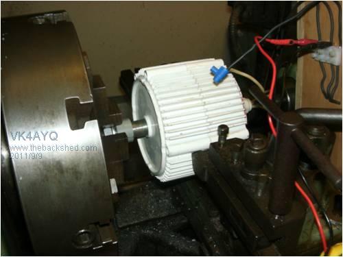

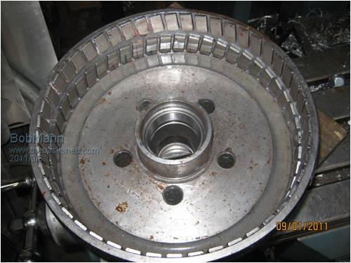

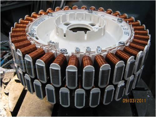

I started to build a Duel Stator using the 60 F&P stator and my Neo Magnet Drum set up. I had all ways planned to add a second stator in side when I started the design.
I am trying to keep the coging down which with my the first design I was at 14 inch pounds at brake away.
So here is some of pic of the build. I am trying some thing that I belive have not been tryed before.
I use 2 rows of Neo Magenet set in a offset lay out to help lower the cogging.
I am trying to stack 10 pound of sh*t into a 1 pound bag.

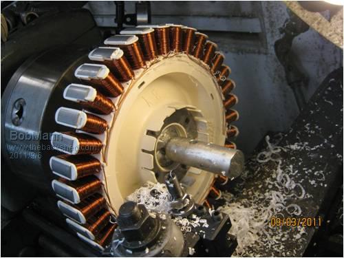

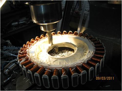

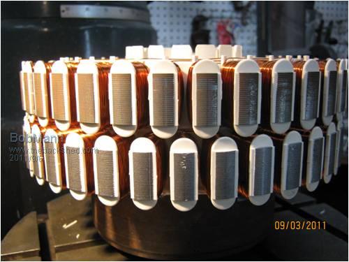

I had to cut the stator that sticks in to the drum all the way. By cuting off
and thing the is passed the coils.
I tryed a few ways to hold each stator by them self to the axle shaft.A had a few not cut it. I still need to clock the stators to see if I could drop the cogging numbers and if it would help on power out put on the test runs.
I had to do more cutting here.
I got what I was looking for.

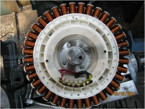

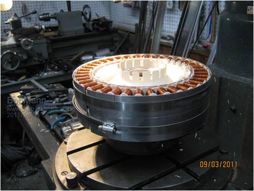

I needed to mount the inner stator in a way so I could find the sweet spot.
By rotating it from the outside end.
I made up the sleve to hold it together
Here is how I held it all together and still can spin it say 20% +- if needed.
I added the allens as to hold it together and as a set of locating pins too.

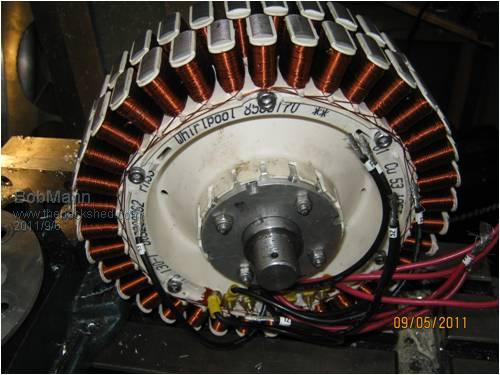

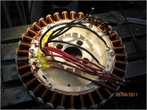

I wired it up like Bob from Down Under had showed me.
I used a pair of colars to holt it to the axle shaft I still had to play with the
depth in to the drum so not to grind up the inner coils.
It looks like I should hit the 3000 Watt marker at a low RPM with this one.
I am ready to do power test and cogging tests the cogging is about the sames as the ones with one stator.
I need some help on the best wiring of the stators they are all hooked up to
bar strips one for each stator to make it easy to do jumping from one to the other.
Delta or star. This is not my strong point.
The other is you can see were I am going with the cogging part. Has any one worked down this path there is a few more compantion that can be tryed.
This is a hard build a lot of Neo Magnets pulling every were. I am hoping to have them all trained not fight me.
For my needs I will use the stators wired the way there are no cutting or grouping coils please at this time of the build we can do that later.

Posted: 02:19am 06 Sep 2011
  Quote  I am trying some thing that I belive have not been tryed before.
One thing I've learned over the years, EVERYTHING has been done before
My own attempt many years ago. It worked, but it had problems because I was using two of the plastic magnet hubs fibreglassed together, and there wasn't enough strength in the plastic, so it scrapped the stator.
But you're using a steel magnet hub, so you will have better luck. I'm pretty keen to see how this goes Bob, keep us posted.

I was hoping you would take a look at it.
I had seen your dual unit before. the point I am trying to make is with the Neo Magnets and steel drum by stagering and and slanting with adjustment of the stator.
Can we over come the cogging to cancel out some of it out of the start up brake away.
and can we adjust the sweet spot for power output. See you will never kill the drum or bearings in this setup so it can be a very simple build from that point.
As you show in your pic.There is a lot of iron there to cut, weld, machine to boot.
Bob Mann
Posted: 03:00am 06 Sep 2011
Yes I think you could overcome the cogging. The stators need to offset by a degree or two, you would need to experiment to get the sweet spot. If you assemble it so the stators are slightly loose, so they find their own point of max attraction, or worst cog, then take off the magnet hub and rotate one stator by one degree or so before tighting it up.
You have a lot of testing ahead of you, but I'm confident it can be made to work. If your sticking to low RPM, then dont worry about rewiring the stator just yet. You will need a separate bridge rectifier for each stator, as they would be slightly out of phase with eachother.

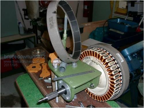

I had a go at dual F@P some years back, must be 10 by now...
I found that the fibreglas or plastic rotor casings were just too flexy--yours are steel so should be good..
I machined a wide wedding ring from stainless steel pipe to seperate the stators, that part worked well,,as I could adjust the inner and outer stator in the same plane a few degrees..
.. I also made a couple Neo magnet conversions that were around the 600 watt ,even more.. output.
I follow every post here every day ,,wish you well ..
Bruce.
here you can see the second rotor ring containing the ceramic magnets machined and ready for fibreglassing to it's mate..

You will need a separate bridge rectifier for each stator, as they would be slightly out of phase with each other. I can set it up to do the recifiering top side and bring it down DC with 2 wires. Most people with not have run a lot of wire.

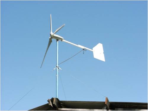

here is one blade and tail set up I will test. Jeff was to sell my VAWT one year later and over 13000 views on this site not a one sold HUM and no leads. But I sell them off EBAY with just a few hundred view???

I have one of these 10 blade turbines and found it quite useful on winds over 5 MS, and really comes on above 8 MS unfortunately the wind is not that good at my place most times but I could see them being very good on your water tower.
I am thinking of making a bigger diameter hub to get some more torque from the blades at low speed.
The people that market them concentrate on their auto alternator conversion that needs a lot of rpm to get the power output. Your lower speed unit may over load the blades at lower speeds, but well worth a try. I have tried them to 2000 rpm mounted on a trailer so they can certainly hold together, I do think a bigger version would be a real winner but haven't seen anybody making one yet (80 to 90 inch diameter)
I use a no slip ring set op on one of my mills for 2 years now, it uses a piece of marine quality bungee cord on the tail which allows two turns in either direction then it pulls it back, before the bungee cord I broke the wires several times from winding up to much.
Not at all hi tech but it works good. with this set up you could use a six wire down feed and allow all sorts of voltage / current options suited to the clients needs.

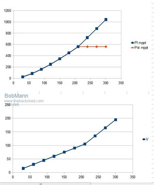

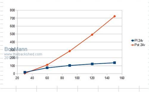

We need to look out side of the box here. my output with my Mann Smart Drive is docmented with the one stator.
These numbers are for a 300 RPM used on a VAWT.
And if you look at Bobs from Down Under he is showing very close numbers on his build.

Your output is not documented by that graph. That's a theoretical curve by someone that hasn't even tested it.
Will you ever post actual numbers taken from your turbine? You ran it throughout a tropical storm. Can you post some of that data?
Don't want another sales pitch, just an output graph.

I stand by my graphs
Perry wrote:
I wouldn't normally hound someone for data but you keep plugging this and posting on multiple threads at multiple forums that people should buy your system. So is it out of line to ask for some performance data? What charts have you provided? I guess I missed them. All I have seen is Steve's predictions and models based on no testing. Maybe I am wrong?
Perry, you have so little faith in my modeling ability. :-)
Just to get all the info out there, this is how I figure out the power (voltage, or current) from Bob's Smart Drive.
1) OCV = RPM * 1.0 (If I ever get more careful measurements, that 1.0 might be adjusted a little, but I think it's very close.)
2) Take a guess at R (resistance) of the alt, say 10 ohms or so.
3) Current (I) = (OCV - Vload) / R
4) Calculate R based on the current: R = 7.5 * (1 + .1 * I + .03/5*I^2 + .03/5 * I^3)
The R you calculate and your initial guess will be different. Go back to Step 2 and Guess at an R somewhere between your initial guess and the results of #4. When your guess and the #4 results are close (0.1 ohms or so), you are done.
This is the method I used to generate my graphs.
Bob recently gave me two current measurements. The real results and the results of my model are as follows:
81 RPM Measured short ciruit current: 4.69A Predicted: 4.76A Error: 1.4%
103 RPM Measured short circuit current: 5.10A Predicted 5.29A Error: 3.7%
For a model that I came up with in 45 minutes or I'd say that's a pretty good fit!
