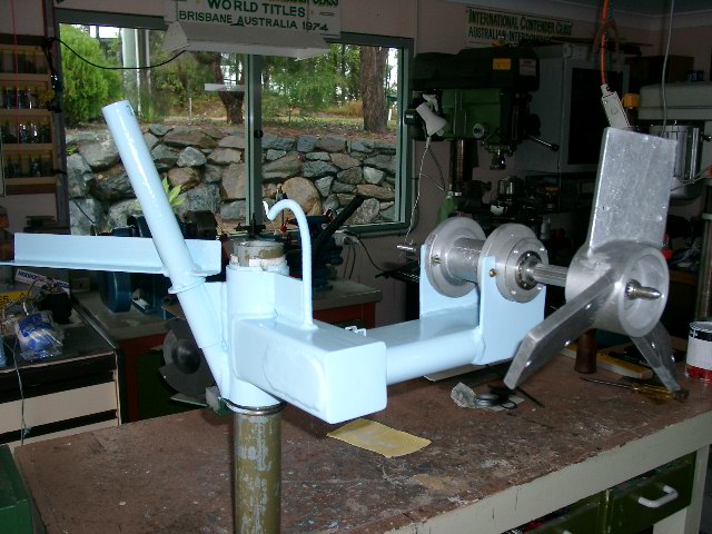

I've sort of finished my new direct drive platform apart from fitting the blades to Trev,s blade hub. In the pic you can see Trev's cast bearing holder and modified spline(extended) on the s/s drive shaft.
This bearing arrangement allows for 2 stators and rotors to be fitted on the single shaft,maybe I can off-set one against the other to sort of maybe cancel out the cogging, we'll see.

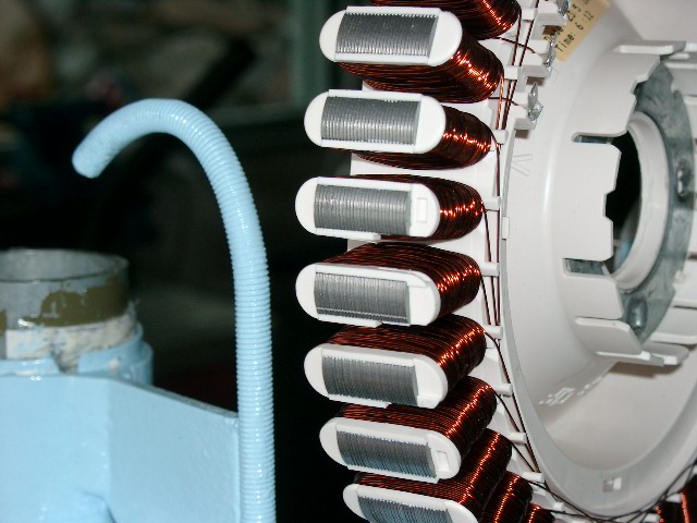

Very interresting looking stator, those curved pole ends have got me a little worried. The new stators have less poles, and curved pole ends, so there is a chance these may make less power than the old 42 pole stators. However, the fact they have virtually no cogging is a big plus. It may end up these are suitable for low wind startup, low power windmills. I can see I'm going to have to get one in and have a play.

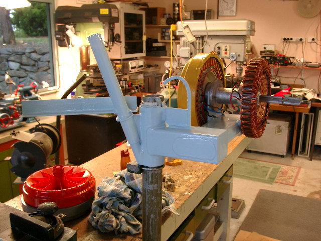

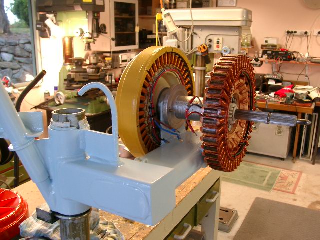

This is the new set-up. Will try fiddling around with the thing today.
By the way , anyone (Trev) got any idea of making a tool to place and remove one of these rotors ,when the special nylon nut is not used. ?. On the dual rotor set-up you have to remove it (special nut) .
Bruce

Sorry Bruce I wasn't suggesting putting an old and new on on at the same time. I was trying to get confirmation of my calcs that for old hub you have 1/4 of a turn on splines for adjustment before your back to the same cogging force. (1/2 a rotation of hub on new type). I frequently confuse myself

G'day Bruce, that new platform looks pretty flash. If I ever get around to making a second mill I'll copy that if you don't mind. What's the bit of angle on the tail shaft for? I'm assuming it's to do with furling.
As for removing the hub after the fp nut is removed you should be able to make extensions on a 3 jaw gear puller or make one from scratch. It appears you have every tool that was invented, nothing like my collection so you shouldn't find it too hard.

With my double White Pointer, I align the poles of the 2 stators. I have North magnet on one motor and South magnet on the other motor. I think its the best for minimising the cogging.
Removing the magnet hub with no nylon nut ( the one at the front), I just pull it off with my hands. I guess if you have a neo conversion on there, then you probably will need to have something to assist removal. A modified gear puller should work fine.

Yes, I removed an "ordinary" rotor fairly easy by placing a board at the end of the s/s shaft ,then against my chest ,and pulled the rotor off with my hands,easy.
The Neo conversion might be difficult,but a simple 2 way puller made especially for the rotor will make easy work of it.
