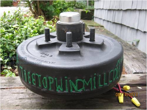

Hello
With the kind of testing and building Bob Down Under and Gizmo have done with the F&P

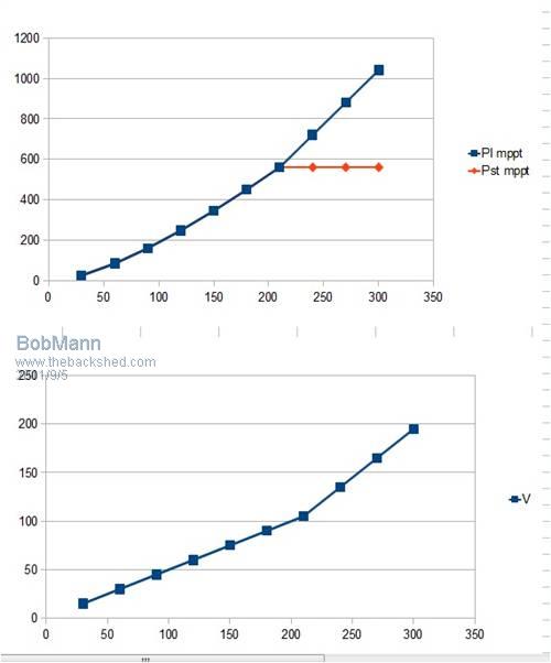

And What I have done with the Mann Smart Drive for wind and hydro it is a great work horse.
My unit out of the box it is 1000 watt unit at 300 RPM.
I would love to have one of you guys to build around it Down Under.
I have orders in the USA on EBay now. To ship it Down Under I got it down to
$200 it weighs 38 LB in the box. That was USA Post. all others UPS,FedX, was $400+

BobMann
Joined: 30/06/2011
Posts: 134
Posted: 04:01pm 05 Sep 2011
Thank you I did not know.
All of you guys have been supper helpful Down Under.
I am testing a duel stator one with luck today to have close to zero cogging.
After I finish painting the front of my house today I will spend some time on it.
