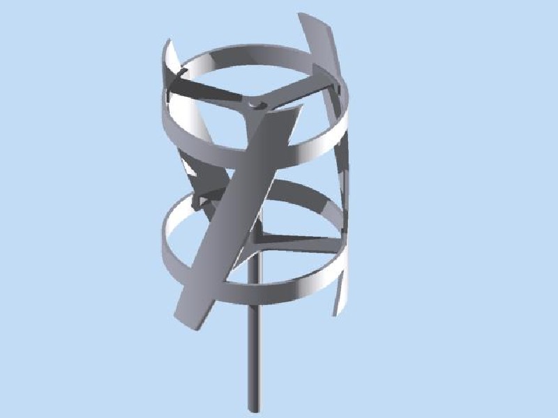

Hi all, Im a long time reader but first time poster.
Heres one for the vawt guys. I was looking at a piece
of dia 400mm PVC I have for hawt blades and wondered if
I could make a vawt out of it.
Has anyone tried anything like this? The dimensions as shown are dia 400mm x 600mm high x 10mm thick.
Leading & trailing edges would be carved into nice
airfoil shape.
Highlander

Yeah it would work. I have a couple of suggestions.
First up, I've marked on your picture where you could leave out the outside hoops, marked with a X. The inside struts will hold the wings in place, and it also means you could make a dozen or more wings from the one length of PVC.
Second, shape the wings to a aerofoil shape like this.
Remember the Darrius wont usually self start, they need a kick to get them going. But once going, they are good performers.

Yes Gizmo your drawing is right on has to what he should do with the blades and supports.
A curved airfoil like that will self start easily.It seems has the wind hits the foil from the side and your off and running.Yours will be a little thin but should still work.
I have no problems with starting.No fidgeting back and forth like some has a matter of fact in high winds i block it off just on one side.Doesnt attempt to back up.
Attach the blades to the rotor at the very top and bottom.
Thats sorta how im doing my rooftop darrius only with many fiberglass blades.Still in the early stages yet though.
Go for it.

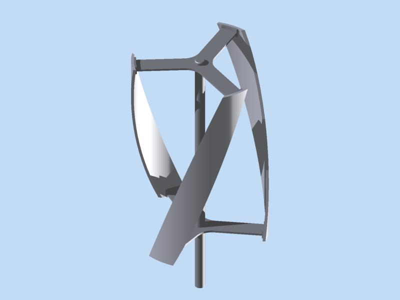

Do you guys mean something like this?

Yess Clogs
I wish i could draw things like that.If you keep the solidity high like your drawing the turbine wont selfdestruct has the sayings about the darrius.
I wasnt planning twisted blades but that might work awesome for ya.

The Helix curved blades are excellent but I think that you can get about the same result from straight blades as long as you go with 3 blades. The helix should have the same amount of blade at all points on the circle. The straight 3 blade is close but is not quite as smooth running as a helix. If you can do a good job of cutting the helix do it but if it turns out to be too hard try 3 straight blades same size. You will lose a little blade surface as a diagonal is a little longer.
End caps might work for support structure. The circles of pipe in the orignal drawing work well for structure support but take out that area of the turbine blades for power production. They also complicate the cutting and limit the number of blades you can cut from a length of pipe.
