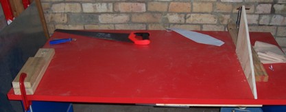

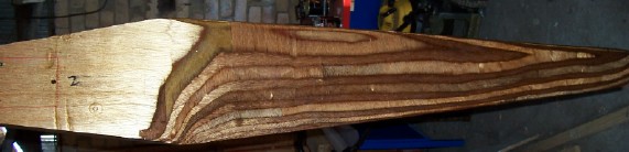

G'day guys I've been trying to come up with a way to make twisted blades that doesn't require too much carving. I found it nearly impossible to get a piece of wood big enough to carve a decent blade that didn't have knots all through it. So I had this idea from my previous boat building work. Unlike building a boat this wood is unsupported so it just a try and see how it goes sort of thing.
I started with 19mm marine ply 1200mm by 600mm and cut an elongated coffin shape out with the middle one up side down to maximize use of the wood.

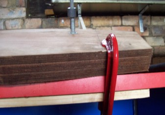

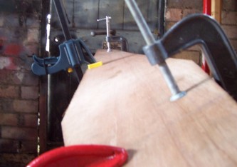

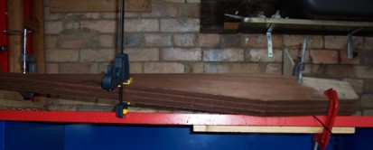

I then left them to soak in a wheelie bin full of water for three weeks. I made a jig on a bench to clamp them to, clamped them in and left to dry, so far about 4 weeks drying.
Now comes to the bit I'm not sure of, I think I'll carve the aerofoil shape on them and poly resin them to seal from the wheather, I think resin would be better than paint as it should soak into the wood a bit and possibly help them hold their shape. It's also a bit more durable I think.
Any suggestions ?
PS if your wondering why I twisted it like that it's to fit the alum prop hub made by Trev
BTW the wood cost $30Edited by Highlander 2006-12-20

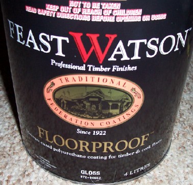

Hey Feral I understand your concerns, but they have been drying for 4 weeks so far, and I was planning on another week more with the heater in the box surrounding it. So they should be bloody dry after that. In the event that there is still moisture there, the moisture cure polyurethane should work just fine. Here's a close up of the can.
This will also cure from moisture in the air and doesn't use glass or other reinforcement as it's a coating.
Trev I noticed a FGI can in one of your pics, they're the guys that advised me to use what I bought.
FGI being a manufacturer with their team of chemists and R&D facility would have been the best ones to consult, I thought. I went to the Melb plant (not a reseller) and a few guys were involved in the discussion and that was what they all agreed on. So if they're wrong, God help me, and I'll try something else.

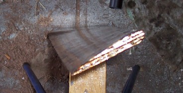

Well the blades turned out well.
They did lose a bit of their twist after the carving of the aerofoil shape was done. The wood which was removed must have been holding some of the twist. It would be better to cut the shape out, carve and then soak and twist. But if you do this you can't stack the blades on top of each other when clamping, due to the wing shape on the blades. So three separate jigs will need to be made for them to dry out in.
I did find a better coating, it's called "spar marine" made for high uv and tough marine conditions.
Yes this is totally experimental. If they hold up well then it's a bonus.
