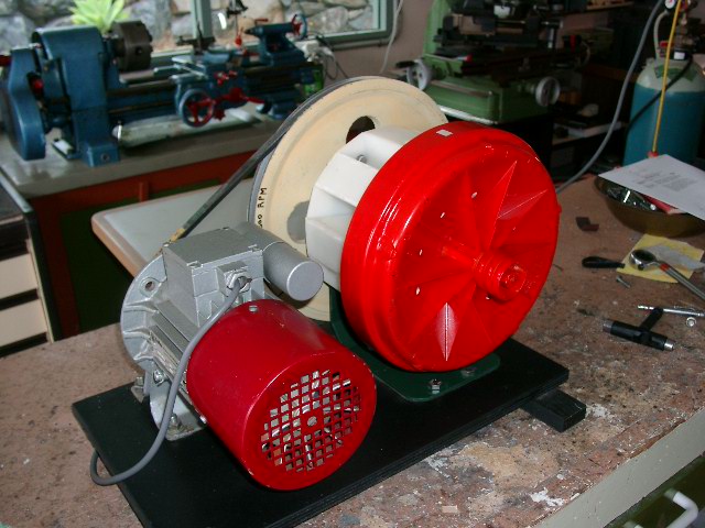

Yes, Glenn,I've done the electrical test on the new 36 pole Stator.
Have to retake the pic's ,as my flash was turned off,and this Old Fella had to read 5 pages of instructions to get the bloody thing turned on again,lol.
1 Phase across the star point produces 244-250 v ac at 574-600 rpm.

hi Kiwijohn, Thanks for that ,I didn't have a load connected ,but maybe I could install another stator and rotor on the other side of the shaft and see what happens . I could short out 1 phase ,this should give it a load.
(I just edited a previous post to show the testbed,smallish drive motor ,but does the trick for evaluation ).
