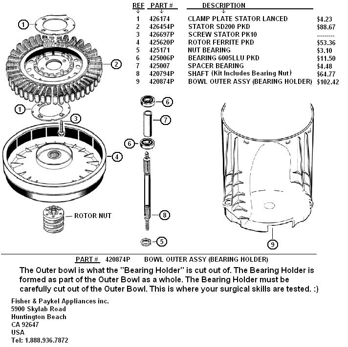

I just recieved my new 36 pole Stator and new Rotor.
S&P Parts place said that some #s have changed on parts.
Stator Part #420775P changed to #426454P ....and
Rotor Part #420774P changed to #425620P
I found a F&P parts place in California USA, if anyone needs the info here it is with part #s. I believe the part #s have changed for the new Stator and Rotor and are reflected in the pic below.
I just got rid of the diagrams I posted here and am directing to your new drawings Gizmo. Nice work! Thank you.

For me, the advantages of this New 36 Pole Rotor are:
1. It can be obtained by those of us in the USA right from the F&P parts department in the USA. Where we would otherwise be stuck-out-of-luck.
Other possible advantages could be that it's bobbins/fingers/coils, are already factory rounded at the ends, which has proven to reducing cogging.
There is the possibility that you might have reduced output as a result, but sometimes less output is better than no output at all if your Mill is stalled because of cogging and doesn't turn at all in low wind speeds.

one thing i have noticed is when my new rotor arives it has a plastic bolt for the rotor nut, not the rotor nut as shown in above expanded view.
unsure why as i have not purchased the stator and rotot just the rotor for the 7 phase conversion
is the shaft different on the new machines?
martin

Yeah thats right.. the '7phase' magnet hubs come with a bolt type nut.. thats normal.. dont use it.. just pull the normal plastic bolt off one of the old '3phase' magnet hubs and put that in instead.. then you can use the old shafts..

One thing I did notice and have done ..
the old style nylon hexagon nut ,,gently cut the end 'cap" off the threaded portion .. now when you want to remove the rotor unwind the hexagon "nut" until it no longer engages the thread. Now thread in the Nylon bolt that arrived and ,by hand ,you can turn this down onto the shaft a few turns and the rotor comes off without pulling it so much. I have stripped off a few threads from previous rotors by having to pull very hard on them ,,the above method will save you lots of pulling and protect the threads.

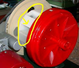

Bruce... What is this part you used here on your testbed? I've got one of the old bearing holders that was cut out of a whole tub, but this looks like a different type of bearing holder that would work well for what I want to do.
If it is a bearing holder do you have a part number so I can order one. Looks like I could easily mount it to wherever I wanted.
