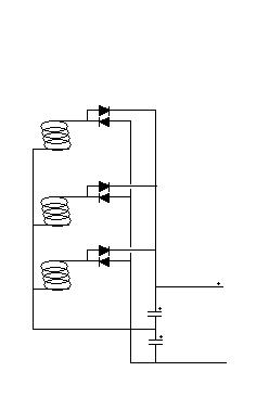

Highlander, this is a way of doubling the voltage (and incidently avoiding one of the diode drops, I think). Through one half cycle one capacitor is charged and the other charges on the other half of the cycle. The output voltage is the total of both capacitors.
The two capacitors could be two batteries of the right voltage.

Voltage doubler, yes... but crap performance at any non-trivial current, and you have to use very large capacitors - and caps of that size generally HATE the high ripple current they are required to pass in this mode.
Sorry KiwiJohn - but not practical in this instance.
Overall, be much better to go high voltage then use a switchmode downconverter. That also significantly reduces your copper losses on the run from the mill to the batteries.

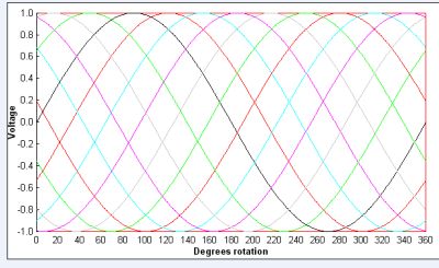

Megawatt Man, Highlander I even sat down today to try and draw the combined waveform of a many poled machine and needless to say it is really quite smooth. Not only are the peaks close together but the peaks are actually quite flat. 21 poles was too hard to plot but here is 11.
Considering how flat this output looks I think it would be interesting to try variations of the voltage doubler circuit I drew earlier.
