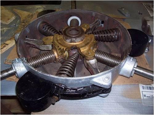

Raptor50
Joined: 17/08/2011
Location: Sweden
Posts: 8
Posted: 08:42am 21 Aug 2011
Oops.. Should have said in the first message perhaps, i don't have it. Just the picture. But i saved the picture becouse i was looking for something like this. But if it's not worth to try to get it, i'll start looking for some other soulution.
