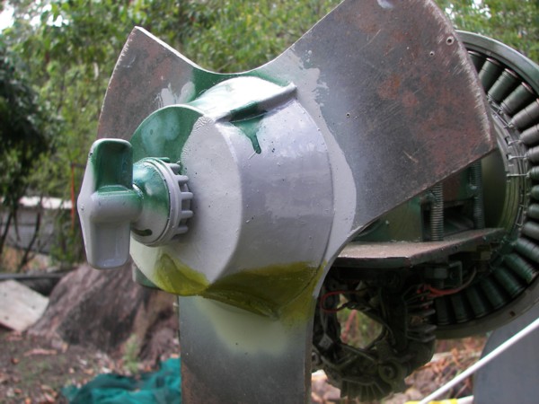

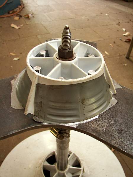

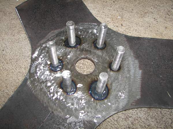

I really struggled to come up with a prop hub for my wind gen. Incorporating the spline was my nemesis. There are few if any suitable designs to pick from. I came up with this use of recycled and other parts so thought to share it in case others are looking for a hub setup too.
My hub consists of the F & P agitator spline and a prop backing plate of steel that is held together with studs encased in a polyester resin filler.
For construction details:- click here

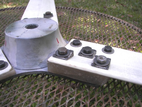

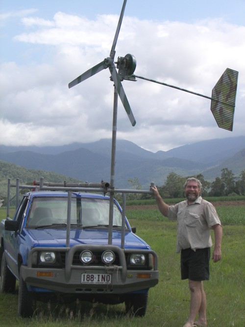

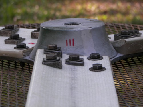

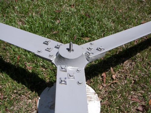

I didn't get to fit the blades I'd first planned on. Instead I fitted the fibreglass Chinese blades.

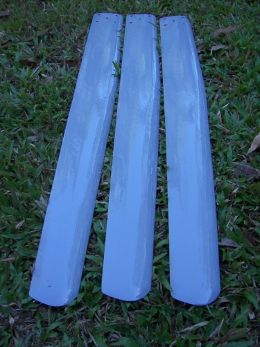

Unlike the intended blades, the Chinese blades needed an adapting spacer to fit the aerofoil profile to the flat hub mounting. They also needed tapered washers so as to adequately clamp the root. In addition to this I used Sikaflex as a bedding/adhesive due to the tear away failures others have experienced.
Due to blades with no twist having a progressively larger angle of attack as they get closer to the root, I chose a small angle of attack of about 2 deg. which gave a blade angle of about 7 deg.
I also modified the blades, but unlike Glenn's, my tapering starts much further out from the root where it coincides with and maintains the blade calculators angle to the tip. The tips and the trailing edges are also reshaped. I am very pleased with the result and performance is better than I expected.

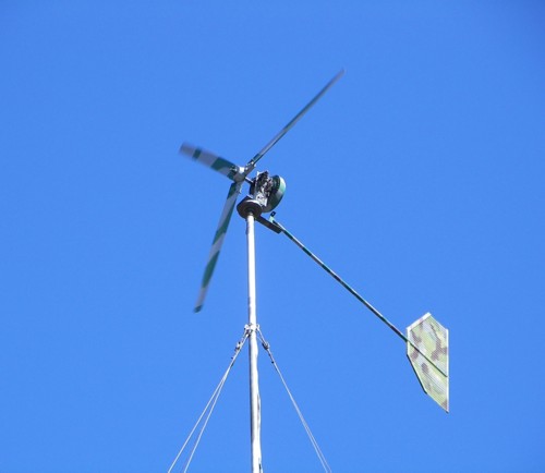

As expected from blades with little twist and taper, start up is a little later @ 15 kph and furling starts at 40 kph (15.7Amps). There is no noise at all unless a wind gust abruptly dies, then flywheeling causes the prop to be a driver instead of a driven (a wind gens reverse thrust) and this causes a chopping/whooshing noise until it slows to match the wind again (back-to-front profile as a fan).
But back to the prop hub... It's worked really well.
Here's some pics from blade mounting to flying.
Top view of root.
Blade angle.
Fibreglass adaptor block.
Modified Chinese blades.
Blades fitted and bedded.

Gill, are you sure the tailboom is strong enough ? In the picture with you and the car it looks as if the tailboom is bending quite a bit under its own weight. Either way it's a long and pretty thin arm.
Gill
Joined: 11/11/2006
Posts: 669
Posted: 10:52am 16 Aug 2008
Dinges,
Thanks for your concern. Yes, you are right, there is a down curve in the boom but it's deliberate and not bending unduly from tail weight.
Cheers Gill _Cairns, FNQ

The noise that the chinese blades make was the reason I canned a chinese mill that I was testing. This was prior to my success with a maximiser. Noise is of primary concern to successful use of windmills in suburban residential areas. I could revisit testing of a maximiser on a chinese windmill when bolty gets his flying.
Are the blades the pultruded fibreglass type?
The chines blades I had, had many small bumps on both surfaces. Did you sand and then refinish your blades after the leading edge mods?

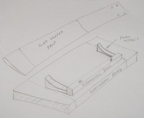

Hi gill yes I would be interested in ha rundown on how you made the adapter blocks for the chinese blades thanks Shane
dont the days seem lank and long when nothing gos right and everthing gos wrong
Gill
Joined: 11/11/2006
Posts: 669
Posted: 02:21pm 05 Nov 2008
G'day Shane,

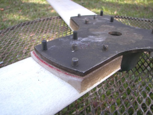

Sorry I didn't take any photos of this part of the prop hub project so you will have to tolerate my sketch instead.
The adaptor blocks are made of fibreglass and are made as a one piece moulding then cut into 3.
A prop blade is used to as part of the mold to give the correct shape.
Wrap a blade in 3 layers of GladWrap for 300mm. Ensure there is no or very few wrinkles on the convex surface.
Wrap a board the same as well as a stick of timber.
Screw the timber stick to the board
Using stick-on foam or rubber strips, build up two blocks that exceed the width of the blade. Cut them into a wedge shape as shown in the sketch. No need to be overly fussy with exact shape and make thicker than needed as they will clamped. Stick them to the GladWrapped board, butting them snugly against the stick.
Press the trailing edge of the prop against the stick at the same time clamping the prop to the board and so compressing the foam wedges. Ensure there is still at least a 4mm gap between the prop and the board at the closest point and adjust clamps to give the desired blade angle.
NOTE: this is blade angle at the Root and not the tip as normally referred to. From memory, I chose 8 degrees for the tip and the blade modification gave 4 degrees between the tip and the root. So that gave a blade angle at the root of 12 degrees.
Now with the prop clamped at the correct angle, mount the board in a vice such that it is vertical with the prop leading edge horizontal.
Mix resin and pour into the cavity adding chopped glass at an even consistency. Be careful not to poke a hole through the Glad wrap. Fill to just overflowing.
When set, remove from mould. The Glad wrap is removed by light wire buffing on the grinder. Cut into 3 equal lengths.
With a small clamp, secure each in turn to the root of a prop and drill holes for the clamping bolts.
After several positioning tests, my final mounting used Sikaflex-291, an adhesive/sealant/bedding compound for a permanent secure mounting. Edited by Gill 2008-11-07
