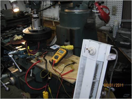

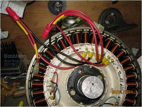

I set up a stock stator so I could wire it as a star or delta and split the winding up.
I am using a 60 unit here in the USA with my modifed trailer drum with Neomagnets set at a 8% angel to help on the cogging. It has been working out very well.
I think it is wired right. I tryed this brass bolts they have worked out very nicely.
I used a elictric base bourd 1500 Watt with 11 OHMS across the to leads and wired it into a control bourd .
This lets me test DC and AC volts unloaded and loaded could not fine my inline AMP meter old one.
Here are my numbers todate this is setup in Delta with 10.3 OHM a cross line A B

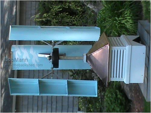

I have 3 tranformers coming I am setting one of my Tree Top Wind Mills VAWT up to charge a 24 Volt battery off the grid home on Cape Cod we are mounting it on the back of his old pickup truck on the dunes out back of the home.

The split up on the wireing looks good as it gives options for different configurations. I have left mine stock standard, only lifting the star point into the three windings so I have only options of star and delta, and letting the transformers do the voltage manipulation.

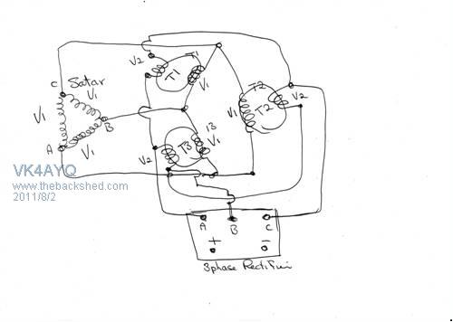

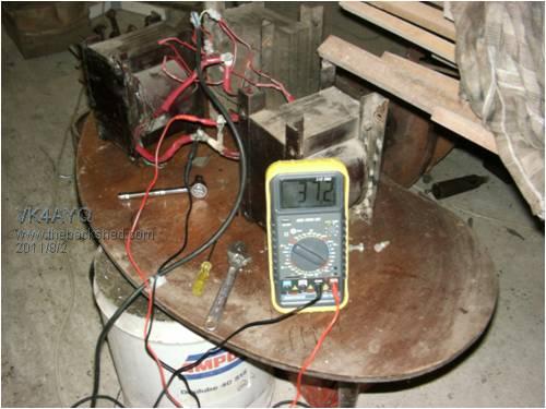

This is the transformer configuration I am using, it is delta to delta but it gives the options of delta star and star delta or star star for different voltage options.
For best output I have delta delta with boost module, but for slower cut in I can use star delta, but it loose around 30 % on higher power settings (rpm) it depends where you want the power band to be, of course on the mill it will depend on the power it can extract from the wind, as in the lathe it has 16 HP to work with so drive variables do not show up.
These transformers are an overkill for the machine as they are good for 1200 watts each at 50 HZ Just that I had them in the parts box (shed)

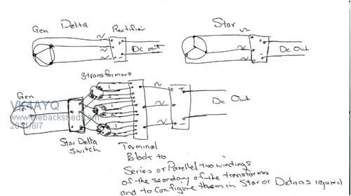

I have been giving some thought to your project and making it as versatile as possible, I have drawn up a mud map of my thoughts to try to help you understand my fractured thinking. The top two sketches are conventional star and delta through a standard three phase rectifier, simple but limited in versatility.
The lower one is a bit complex in that it uses a star delta switch on the generator windings then the three transformers as we discussed, the transformers have two secondary windings of equal voltage say 110 volt primary with two 15 volt windings that can be series ed or paralleled to provide two voltages and then on the same terminal strip the outputs can be connected in star or delta before going to the rectifier.
While this may seem a bit complex it allows a number of voltages to be configured for various battery or GTI applications without loosing to much efficiency.
All the best

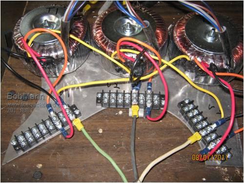

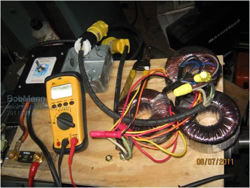

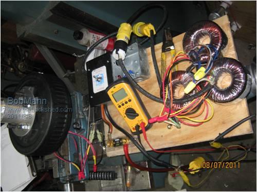

I got the tranformers
http://search.digikey.com/scripts/DkSearch/dksus.dll?vendor= 0&keywords=vpt48-5200
Bellow is a some pic of you set up will build a nice box today
I talked with Tech support the gave me this one i think it may be over kill but I am tested last night it works. I will do more testing today its raining good day for it.

So what you are saying if I switch the secondary wiring on on one tranformer I can use a devent wiring set on the other to make up the right Volt spreed Cool.
I think this is the fix for my USA market as I said you mates are way a head of us on this stuff.

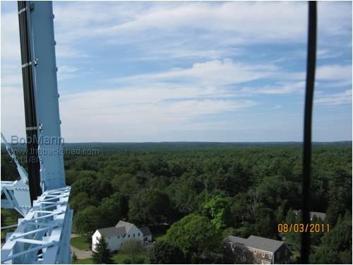

I have the data looger up on the water tower at the 120 ft mark been working the last few days I will check on wind speed to day. I should be up with a turbine at that spot this week with luck.
Thank you very much all of you.

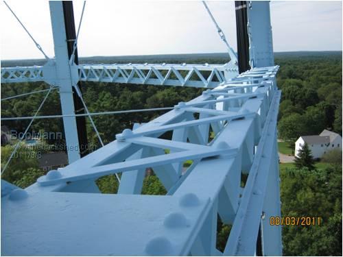

Here are few pic of the water tower
Here is were the turbine will be located for the firsr test mid way out.
Here is the view what till I get to the top of the tank at 200 ft
I would like to build a apartment in the tank it is a monster. It is not used any more dirty.

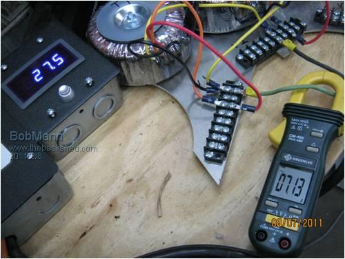

I have full day of testing and I must say Bob Down Under you right on the money with this.I stayed in the Delta group for both stator and transformersbut added you strips.
I wired it as a 220 volts primary was the best on that end.
For charging the batterys it works like a charm.
low speed charging 24 battery bank that is AC AMPs
I set up 3 transformers in delta for now this is the fix for the battery off the grid set up.
I have tested today working well and I can change wiring around a bunch.
I then wired it to drop it for a few grid ties for some testing I found that the power jack worked ok but if I found if you get it working say 200+ Watts then it drop below the
