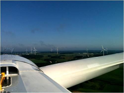

P.S. Sitting up top eating my stale sandwhich with a view tonight!
