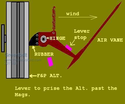

Rastus
Here's another Rough Idea, all Mechanical,Perhaps something similar could be useful?
------Cheers, Roe

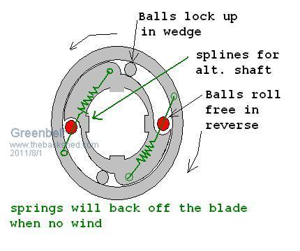

Greenbelt
Joined: 11/01/2009
Posts: 566
Posted: 02:46am 01 Aug 2011
domwild
Here is another Possibility,
Most of you are familiar with an over run clutch. a device that is built like a Roller bearing with an oval race. the rollers are forced to climb an inclined plane by the outside portion of the clutch which would be connected to the turbine blade,
As the outer part rotates the rollers bind up as the clearance between the inner hub
and the outside ring diminish. this effectively locks the turbine to the alternator.
Sometimes the clutch can be found on Gearboxes.
If custom built it may be possible to get 1/3 free revolution before lockup.
------Cheers, Roe
