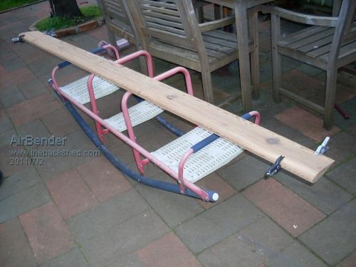

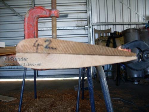

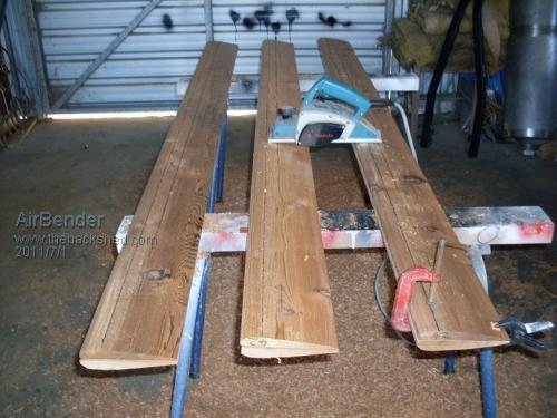

I have finaly started a bigger wing build having pushed a few other projects aside for now. We have only had light winds for the last couple of weeks and the mill has not been making much power, which has got me going.
The new wings are being built out of cedar weather boards, I chose cedar as they should weather very well.
They are 2m high twice the hight as my old ones and they have a cord width of 14cm.
Each wing is made of two weatherboards that i plan to stick together with liquid nails and a few wood screws. But before i stick them together i plan to hollow out the inside, apart from where the mounting points are to lighten them up as much as possible, as i am doing this i will start to weigh them they so i can get a good balance.
The profile has been roughed out. Hopfully tomorow I can get the sander out and finnish the profile off.

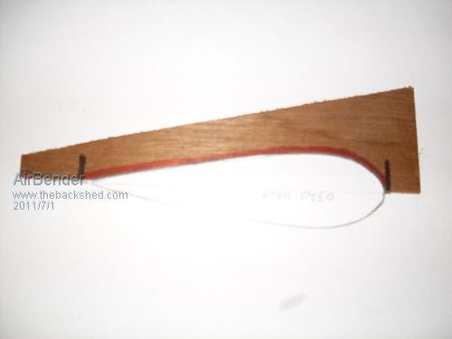

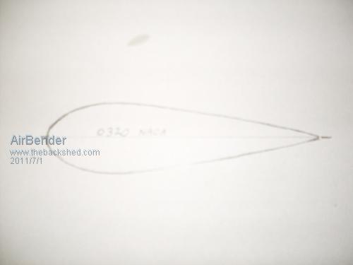

The profile I have drawn up I have calculated to be a 0020 naca. Which i hope will give me good start up and low to moderate wind performance. I plan to run it with 0 deg AOA, but as we know our best layed plans can change.
I have just made up a plywood profil stencil to use while sanding them.
I think i will need to beef up the rotor arms a bit. I think these wings will realy try out the structure of the rest of the mill.
I will try to keep you updated with this build as it progress.
All the best Dean.
Posted: 12:53pm 01 Jul 2011
Dean, me thinks you might be pushing your luck too far by using "liquid nails and a few wood screws".
Especially so if you are removing much bonding area by hollowing the laminate.
For this job I would use nothing less than epoxy glue to stick the laminate together, this has the added advantage that no wood screws (potential water ingress) are required.
In an earlier tread the centrifugal forces on windmill blades was explained very well, it might be a good idea to look it up and see what your blades have to hold up against.
I would also coat the whole finished blade with epoxy to seal it before painting it to protect the epoxy from UV rays.
The old motto 'if a job is worth doing one ought to do it well' comes to mind, especially when potential missiles are created.

Posted: 01:29pm 01 Jul 2011
Thanks Tinker
I think you are right, I used epoxy on my last wings and for each wing I glued eight peices of wood together, and they have shown no signs of deteriation on these joins. It is just that these wings are a lot bigger and i was thinking of the dollars. But i think a bit extra spent now will be worth it in the long run. So I will have to get a tin of that good marine epoxy.
Also at the fastening points i plan to bolt through both laminates and use big body washers this should help to keep it together as well.
All the best Dean.

Posted: 03:54pm 01 Jul 2011
Hi all
I beleive i have miscalculated the naca, after recalculating I came up with 0028.
All the best Dean.

Posted: 07:14am 02 Jul 2011
Hi Rastus
I realy do like liquid nails, i think it is the best value for money glue you can buy. You can just about fix any thing with it. I put it right up there with duct tape and cable ties, I found it will glue some plastics that most other glues wont. But i think epoxy is better wood glue.
I got two wings sanded today, only one more to go.
I am back at work tomorrow for 4 days but then i get 4 days of, so i will be able to get stuck back int it then.
All the best Dean.

Posted: 01:52pm 02 Jul 2011
All the best dean,
Looks similar to GOE222, is that right?

Posted: 11:41pm 02 Jul 2011
Hi vawtwindy
It is a bit diferent to the GOE222 which is not symetrical.
First i drew up what I thought looked good, then i looked around on the net for similar profiles and how they perform for confermation. One place I looked in was Smithys link to fluid modelling, which i am not shore how acurate the simulation is to real life but it did get me in. The one on the link that i found closest to mine is the Remkick 5 which seemed to have good perforance in the areas i was looking for. Mine is not an exact copy of this it but looks similar.
All the best Dean.

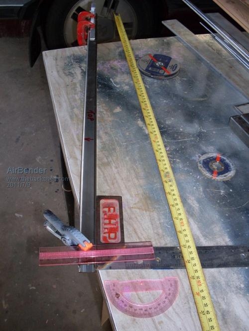

What I posted earlyer that the aoa would be 0 deg may be a little misleading as the way i look at aoa is the angle of the trailing edge to the swept circle of the wing. I think this is more importent than the aoa of the leading edge which is roundish and will take a range of wind angles coming into it. The small wings I have up know are very ajustable and after playing aroun with them i found 0 deg aoa on the trailing edge to be to best setting for combination for startup and general performance.
I worked this out today for my wings to obtain the 0 deg on the trailing edge I need to set the centre line of the profile at 92 deg from the rotor arm, this has the leading edge slightly angled out. Decreasing the diameter, lenthing the cord or moving the mounting point forward on the profile, will increase the the centre line of the profile to the rotor arm angle to retain 0 deg aoa at the trailing edge.
I am not saying that this is the correct way to do it, it is just the Airbender theory on aoa.

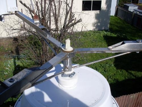

I have sanded the last wind and have the steel for modifications I am doing to the mill structure.
I plan to still use the original rotor hub but every thing above it will be replaced.
The hub has a lenth of pipe that fits over the original F/P shaft ond has sleaves fitted at the top and bottom to make it a very neat fit on the shaft. On top of the pipe I have welded a milk pipe nut which has 5 sides to which I have welded 10mm plate for the rotor arm mounts, and to thest i have braces welded domn the the pipe. In side the pipe nut i have fitted plastic spline out of the original wash tub.
I took this picture when i was measuring up the the diameter.
This is how i worked my AOA.
All the best Dean.

I am just correcting my last post
The milk nut on the hub has 6 sides not 5.
All the best Dean.
