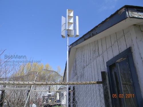

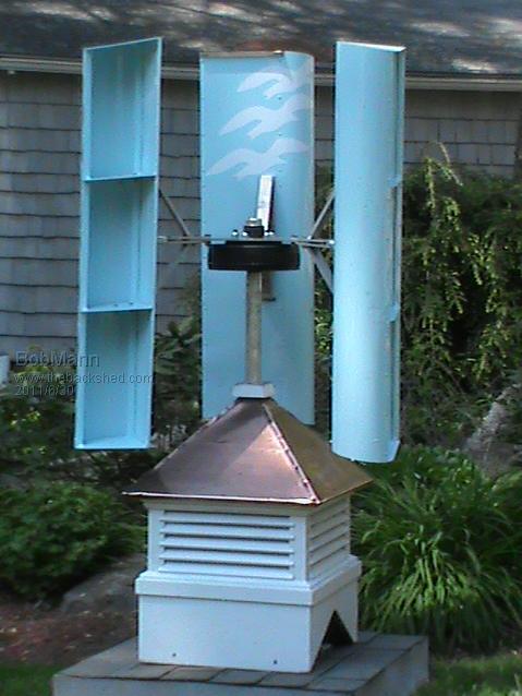

Here is my Tree Top Wind Mill with the Mann Smart Drive I know I changed the the name but I did do a lot of upgrades.

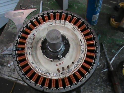

Here is the back side of the power unit

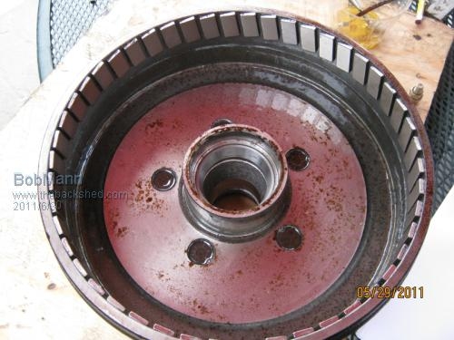

Here is the drum with the upgraded NeoMagnets
I use a premade steel drum with HD bears and hub that will take 3500 LB of
load all day long and is water tight. The axle shaft is ready to go just some machine work very little.

The generator looks good, very solid. I will be interested to see how it goes with the NEO magnets.
Looking at your blades though I think the may be subject to flutter in turbulent air due to the single mount point on the generator. Maybe a star stabilizer on the top would stiffen it a bit.

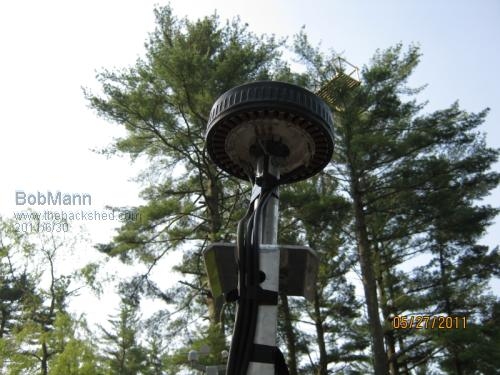

Below is my tree top mount and in the upper corner on top of
the tree your will see my crows nest 90 ft up for testing.

Very impressive, you must be watching those logging guys on the TV.

He He love your tower me and i bet most others have thought of doing that!! You had the guts to do it!
just don't get hert it makes small wind power look bad for us all.
