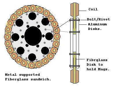

Efficiency goes to Pot when you gear drive your Vawt.
I have had this on my mind for some time. so Have a look at this and see why There could be great advantage by incorporating this into the finished project.
A direct Drive alternator in a VAWT Can be almost any Design you can dream up because size does not interfere with the Blades. Weight is a factor But spider weight framework can be strong. Neo Mag's and air core coils at Greater Radius will reduce the Cut in rpm.
This is what Bob did to his blades to get a little more Torque.
You can see that a little more hub size would not disturb this Design.

Hi Guys,

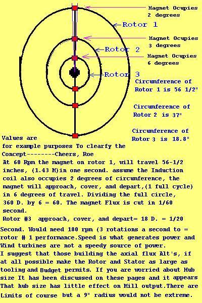

Thanks for the interest shown, Work in progress should not be altered to mess around with this.
Those who have not yet begun to build should consider this option.
It does not have to be a monster to build a 18-24"inch(46-61cm)Rotor/Coil Alt.
A 1.5m. (5ft.) dia. VAWT. Would be a good size to learn about whats needed to make a
real Producer. Keep the Mags small and weak, close together and lots of stator
coils with minimum wire turns and series connected.

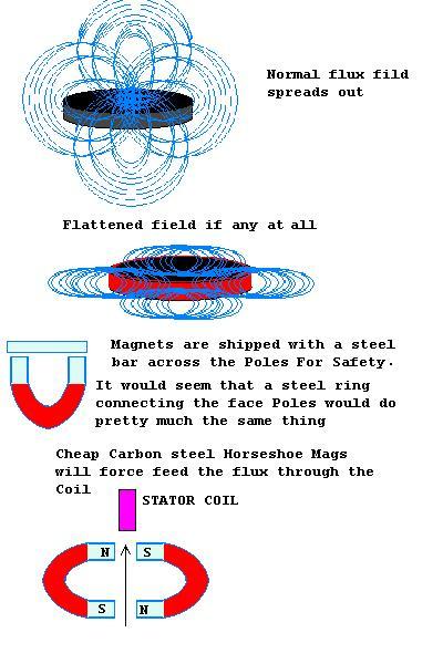

  Xmaswiz said   since it is an air gap basis, would there be any benefit to have steel just around the circumference of each mag separately (creating a ring around each mag at same thickness as the mag), and use dual stator design instead of a steel plate for the rotor(s)?
Assuming you are talking about a disk type magnet and its magnetized so that the N&S poles are on the circular surface - on opposite sides.
Now, think about what you asked. Imagine the magnet is suspended in free air somehow and the magnetic force lines are visible.
You would see them coming out of the N pole face and wrap around the edges to get the shortest distance back to the S pole face.
About the middle of the magnet pole surface the lines have to travel further and their concentration is less.
What you want in an alternator is to have as many magnetic force lines as possible travel *away* from the pole surface, straight through the coil and to a iron path (or another magnet as well) on its other side, from there to a similar set up to the iron backing of the first magnet to complete the path of the magnetic force lines.
What you suggest would seriously short out the magnetic lines *before* they have a chance to travel through the coil and do their work.
You might want to draw that out so you can see what I mean - I'm no good at doing fancy drawings on the computer,

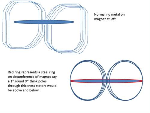

example with ring around circumfrence (red ring ) field line pulled in against the side of the magnet, but stil free space up and down, this is a question about how the lines would react with just a ring. The idea is still for airgap but dual stators one below and one above the rotor. excuse the bad drwaing.
hope this makes sense at all, sorta like a cup magnet but no cup just the edge of the cup?

I would suspect that TINKER is correct about the shorted Field.
The steel plates used to mount mag's is normally supposed to link the fields on the back side to prevent flux leakage (expanded field) This apparently helps to concentrate the intensity of the field at the working pole face.???.
The drawing below is my take on the flux field.
Tinker, Thanks for the Info. ----Cheers, Roe

Mac46, what you suggest is just how a car alternator works. It works very well in a car as it runs at high RPM.
For a windmill you would have to rewind the stator form a few turns of heavy wire to many turns of thinner wire. Doing that would make it useful at lower speeds but you trade off the high Amp output of the original version.
Basically simple is best, a rotor with permanent magnets requires no electric power input, no slip rings & brushes and external power source provide it.
But, by all means do some experimenting with that idea, just remember to deduct the power at the field from the output to get a net power generation figure.

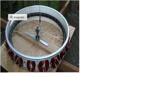

The Best I've seen in design and strength
On page 5 of this post it is obvious that this is one strong frame.
Though Glen chose a magnet plate Diameter of almost a foot,(11.85inches,300mm.)it could easily be made several more inches Wider.
For such a Build I would make a 8-10 sided plate with the necessary extra Bolts an add a stiffener ring to the rear magnet plate at the center cut out.
EDIT; The stator may need to be Stainless or Alloy aluminum to help reduce flexing on
this larger Diameter.
As Glen proved the Neo's can move the electrons, His 10 turn coil can produce 2.28 volts.at 133 rpm. This is 1 volt to 4.4 turns of wire, 62 turns = 14 volts. 5 coils in series for a grid tie at 70 volts, 133 rpm. Glen would need 75 turns with 4 in series for 68 volts. "pretty Nice!"
--------Cheers, RoeEdited by Greenbelt 2011-06-19

naill 1
You know , I'm aware of eddy currents in magnetic Iron/Steel and always accepted it as a part of doing business.
The silicon steel laminates kept the system fairly efficient and was not a problem So I am not as sharp on the non magnetic metals, I assumed it would be a small amount and not a great concern. Thanks for calling me on it. This could save someone some money and lots of time.
You're Right, an education for Dummies like Me
I have a Fix though,
