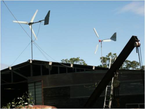

I would suggest that you match the blade loading on the two mills so they perform more or less the same and then series the two to get higher voltage, if possible wire them to delta as this will give a efficiency increase of nearly 30%.
The photo is both mills in the same wind 4 MS OEM producing 300 watts and the 500 watt version of yours producing 90 watts.
I found that it is better to go to delta as in star the internal resistance of the windings is double but the voltage out under load for star is 1.5 times delta.
This i believe is caused by two factors
1. the increased internal resistance in star.
2. The phase angle losses between the two windings in star.
The alternator is about ideal for 24 volt systems but at the top of its range on 48 volts, as I posted earlier the machine will drive good power at lower volts and thats what I pick up with the boost converter. It is not so easy to get a boost converter off the shelf for 48 volts however it is possible to put one 24 volt one on each mill and series the outputs to 48 volts, that could be worth a try, as I believe based on the performance of mine that you would get 300 watts on the boost module before it goes to the main rectifier in higher winds. Mine does 600 watts on the boost module before going to the main rectifier, so I gave a conservative output on yours.
As your test showed they are happier at lower volts on lower wind speed. When they get rated wind speed they go wild and produce much more power than rated 8.5 MS for 500 watts I believe, can't find the destruction book to check that out at the moment, the wife has been spring cleaning and has snuck into my office as well. Not sure which is worse wife in clean mode or grand kids in wild mode, at least I can bash them a bit, and only get called Grump par.

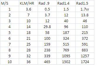

Hi Vic,
Below is a table I made up showing what output can be expected from different Dia/Radius blades , this was done using the Blade Caculator at the warlock site , there are other caculators "Altons" that I think Bob has used in the past.
It shows 3 blade sets R.9m R1.4M & R1.5m and what is the predicted output in wind from 1m/s to 10m/s , the tsr was 6 and the blade eff .3 for the R.9 and EFF of .4 for the other 2 which are the GOE222,it is debatable as it goes against Betz's Law. One thing the table points to is that size does matter with wind turbines.
If you go to the PICLOG page HERE where my 48V Mill is logging and put in 24/5/11 and 25/5/11 into the Dates filter and hit apply , it will bring up 2 days where I had reasonable wind . If you then click on the WIND V POWER , it will bring up a scatter graph and by running your mouse over the dots it will show the output for a given wind speed .
Because my annemometer goes up in 3 klm increments it will give a number of outputs at a given W/S , I usually go about the middle.The annemometer is a Davis and is calibrated to my Davis Weather station so it is fairly accurate.
It pretty much traces the output of the graph for a 2.8m blade set give or take some wild readings that are in the middle of nowhere, and taking into consideration that that logging will have a percentage for error. For the application we use the loggers for it can give you an accurate enough idea of how a mill is performing which can not be done by watching an amp meter and assuming windspeed or even trying to watch a cheap annenometer that updates every 120sec, which is what I tried a few years back.
Getting some form of logging would definatly shed some light on what is happening.

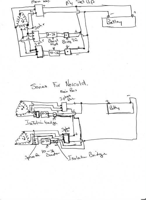

Posted: 07:25am 16 Jun 2011
Hi Guys
Sorry it is a bit rough, but I got the shakes a bit.
First one is my mill with two boost circuits on it
1 a 4 volt to 35 volt at 3 amps
2 a 11 volt to 35 volt at 9 amps
each has its own input 3 phase rec and a bridge on the output for isolation.
Suggested for norcold
two mills wired in series and delta connected with a pair of boost modules also wired in series and isolated bu bridges on the input and the output.
All the best

norcold

Notice in your sketch of your setup, you use 3x3Phase rectifiers. Would it be possible to run the boost modules in parallel off the one rectifier DC outlet? If so believe this would remove some loading. Going further should not just one rectifier be enough with the two boost modules and the direct output to the battery? Have ordered 4x60v boost modules as it seems my magnet alteration idea has little support and thus probably "hare-brained", and will have to trial other ways to get these mills working on 48v. Glens rewiring would work but I`m not that keen. Leaning towards trialling the boosters first than rewiring one mill to delta. Have given your idea of of connecting in series the DC of the 2 mills, but have noticed although my 3 mills are all within 50m of each other, one or two or three can be producing singly or all and not all tracking the same wind direction. Tried the Jaycar at 15m height briefly but let it down to 10m for safety reasons. Must build better towers to get that kind of height.
