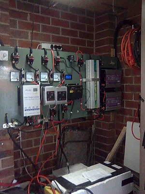

Fernbrae
Joined: 06/10/2007
Posts: 7
Posted: 11:23pm 15 Jun 2011
Hi Gentlemen ,
have a look at the attached compasny , I have 2 of their 500 watt Grid tie inverters , hooked direct to solar panels , they work extremely well.
They also offer a wind type inverter , have not tried this .

This is a picture of my set up
Living loving life always
