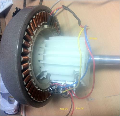

Have trawled through but can't find any similar problem so here goes.
I have an unmodified 80S stator which I have now decogged. Unloaded it spins beautifully and makes lots of volts eg 60v when spun by hand.
When I hook this up to my 12 V charge controller and batteries, which is effectively a dump controller, it is as if the motor is shorted and barely spins. ie takes a big effort to spin it by hand. Volts go up to 12 immediately with 1 amp. Wind would never spin it. When I actually short out the motor it is even harder which I expected.
I know it needs rewiring!
Now the 7x2c is what is recommended.
My concern is that I am going to go to all the trouble of rewiring and find it still doesn't spin.
I don't really mind if I don't get lots of amps out of it, I just want it to spin.
Has anyone else tried the unmodified stator and found it hardly spins?
Will the 7x2c make a magic difference?
Here is my connection setup.

Gary, a connected meter puts about zero load on your F&P - easy to spin.
A 12V battery puts *heaps* of load on your F&P if its unmodified.
Try to connect a 12V light bulb (10-20Watts) to it to see it producing power while spun by hand.

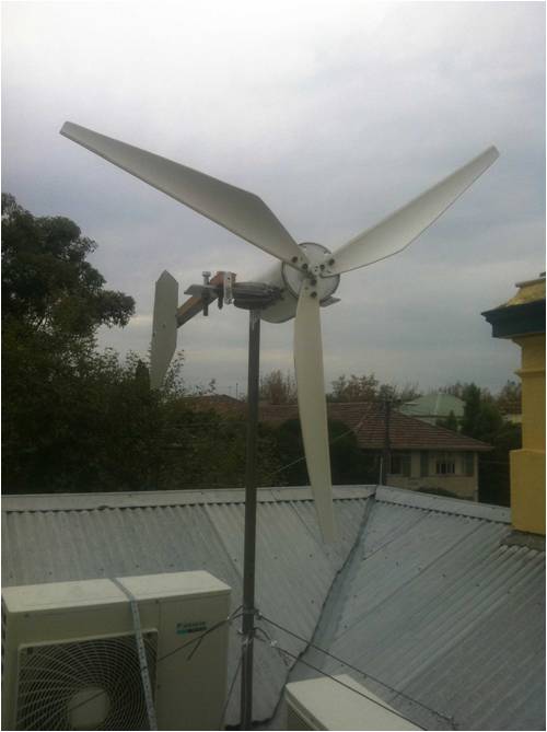

This is my current set up which is for a small but heavy treadmill motor.
It produces 6 volts at best, which is why I'm replacing this with an F&P motor.
Treadmill motor specs (120v, 5amps, 4000rpm) mean it needs much higher rpm to achieve anything. A lot of work for nothing really. Just looks good when it spins.
Will be aiming for a sturdier pole/tower for the f&P.
Was considering using the same fly wheel to attach to the shaft of the F&P but will need boring out. Current radius of blade (pvc) is 75cm.
