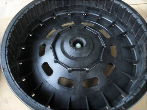

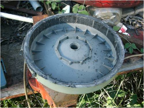

Acquired the latest 48 magnet hub seems to have a different magnet set up than the previous.Seems to have a Smaller vertical magnet configuration.
Rewired the 36 pole stator as a 36dc 1S -12P Delta spinning by hand produces 6 amps plus, have not tried with blades yet. I compared the older 48 magnet hub with this newer hub, and the output seems very similar. The great thing is yes these 36pole stators are cog free. Also this newer one is branded Whirlpool Fisher & Paykel.. Will post actual test results when I get the windmill up & running Cheers

would you replace the magnets or overlay them on top of the existing ones after grinding down the poles a bit? what would you suggest as the best method of removal if going that route?

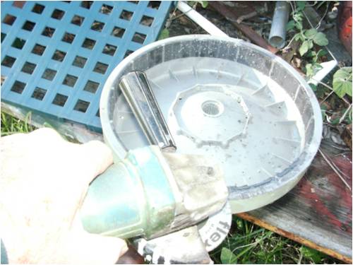

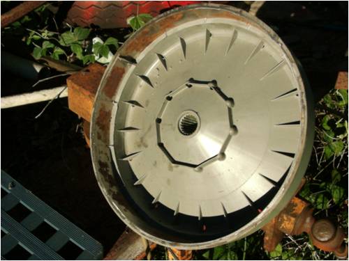

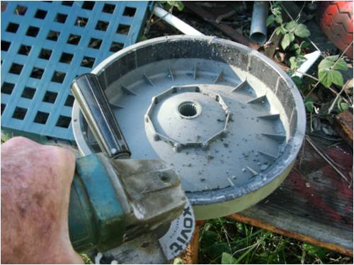

Not sure if this will suit your rotor as this is an earlier one I am doing at the moment.
Grinding the outer plastic of till I get to the steel backing ring.

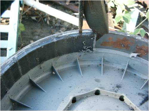

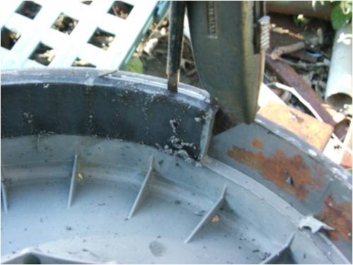

I then heat the magnets with a heat gun to loosen the plastic bond
I work a Stanley knife behind the magnet when hot and then follow with a sharpened screwdriver to pop the magnets out.
This one was an easy one as it had no plastic behind the magnets only on the edges.
When using the head gun cut a circle of tin plate or aluminium to act as a heat shield on the center portion of the rotor to prevent distortion.

I 've done 4 of these and an LG type rotor .. I've purposely broken the first magnet , then use a 1/2 inch chisel from there. Generally break a few ,,but when you get the gist of it you get them out clean and fast. then clean up with sand paper and a smaller chisel the plastic ..
Forget about grinding down the "fingers" of the stator ,IMO.
BUT,,, I would consider looking at the LG type of motor instead of the F&P... Really , it's a much bigger , stronger, easier to rewire and all round better bearings and 'adaptability" IMO. I've not made mine yet , but have removed the magnets and dismantled the units - A case of too many projects on at the same time..

thanks all for the replies, I have the rotor that looks like the one at top of page. I'll prolly use the chisel method.
