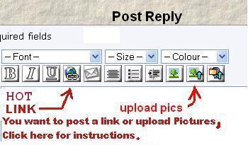

To attach pics ect you have to download them using the "image upload" 2nd from RHT Edited by fillm 2011-05-30

Here is a little help using the post format buttons Cheers---Roe
