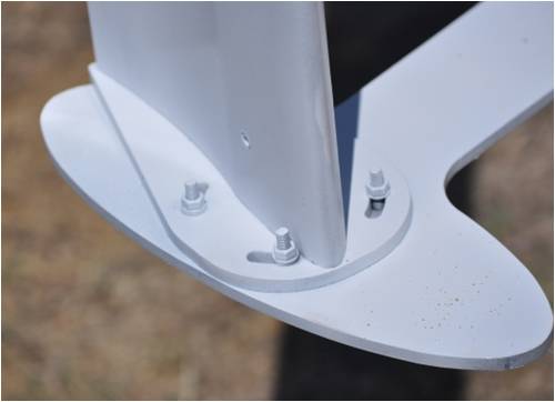

The blades for the VAWT I sourced from Phil on this website DIY Parts whilst I am using a Ginlong PMA, but a suitable configured F&P would also work quite well.
The Airblenda is designed to have interchangable Airfoils, PMA's, and also uses laser cut aluminium stays, all of which can be altered based on predominant wind speed, and desired characteristics and end purpose. i.e grid tie, or battery charge, low wind environments etc

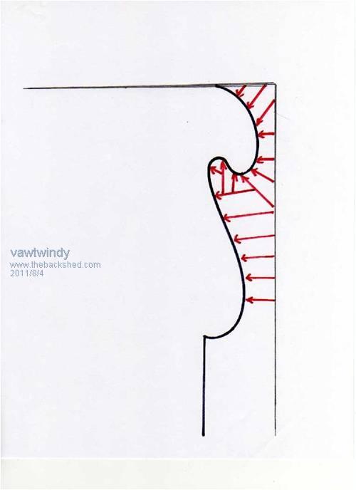

as you mentioned in youtube,
@Airblenda since it is swirling wind (is that a right term?) why can't you think of having small curves in place? like this
, by doing this will the torque shoot up? might be a difficult task, but i felt it might help you?
